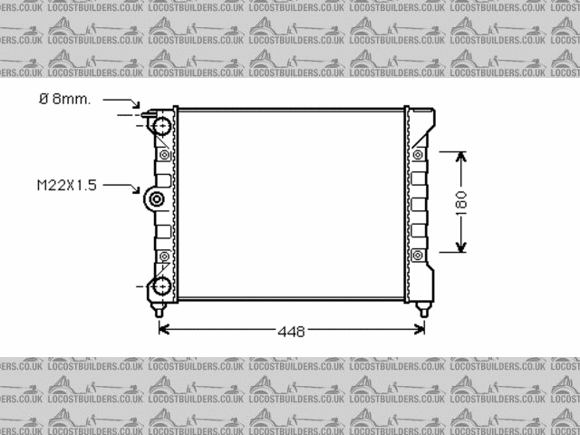

hi,
can anyone tell em the dimensions of a polo rad and where the connectins are please??
I run a Escort rad at the mo but need to find some space for hoses to pass it.
cheers to all
dunk3
posted on 4/9/09 at 07:06 AM |
try this place, advanced radiators, the polo rad model number is VW302, its only £38.69 deliverd
[Edited on 4/9/09 by dunk3][img]http://locostbuilders.co.uk/upload/a1010346-vw2038[1].gif[/img]
dunk3
posted on 4/9/09 at 07:13 AM |
sorry about the size of picture, is this any better
![](/galpreviews/a1010348-polo rad dimensions.gif) ![Rescued attachment polo rad dimensions.gif](/gallery/a1010348-polo rad dimensions.gif) Rescued attachment polo rad dimensions.gif

BE careful. Some polo rads are bigger. I nearly brought one that was 29" wide

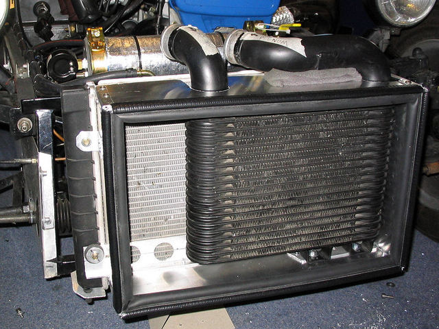

bimbleuk
posted on 23/9/09 at 08:44 AM |
quote: Originally posted by goaty
quote: Originally posted by bimbleuk
270 BHP in my kit car and no problems with the Polo rad keeping it ccol. Tested on road and track.
Is that a standard one or an ally one?? i am going to get a radtec style one....
thanks again
Plastic end caps and an alluminium core. So yes standard rad as fitted to a lot of Polo's.
![](/galpreviews/Intercooler_mounted_front.jpg) ![Intercooler mounted](/gallery/Intercooler_mounted_front.jpg) Intercooler mounted
![](/galpreviews/Cowling_2.jpg) ![Radiator cowling](/gallery/Cowling_2.jpg) Radiator cowling
