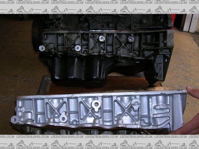

Sump mods before/after
norfolkluego
| posted on 2/12/09 at 07:44 PM |
With thanks to Numb nuts, his engine/garage
norfolkluego
| posted on 2/12/09 at 07:45 PM |
PS the shiney one is after

is the black top sump a direct replacement for the silvertop one ?? I retained my alloy sum had it shortened and modified to clear the starter.
What is the cost of the black top sumps
