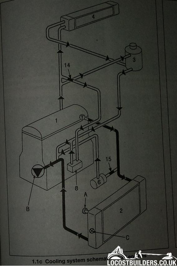

l0rd
posted on 6/1/10 at 12:32 PM Reply With Quote
http://www.locostbuilders.co.uk/upload/Photo043.jpg
flak monkey
posted on 6/1/10 at 02:06 PM Reply With Quote
Thanks for that, looks like the bypass pipe will be fine
