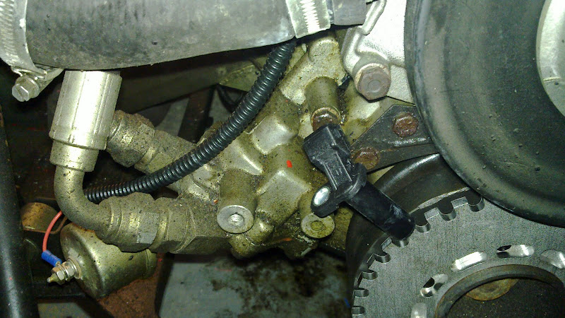

My set up....
if you want to mount the trigger wheel on the front of the pully then I have a spare 5mm spacer that may help, correct bolt pattern for pully.
scudderfish
posted on 11/2/10 at 08:14 PM Reply With Quote
That's very interesting. Your alternator is in the same place as mine, but your water pump looks to be offset to the left. Do you have any other photos of the front end of your engine?

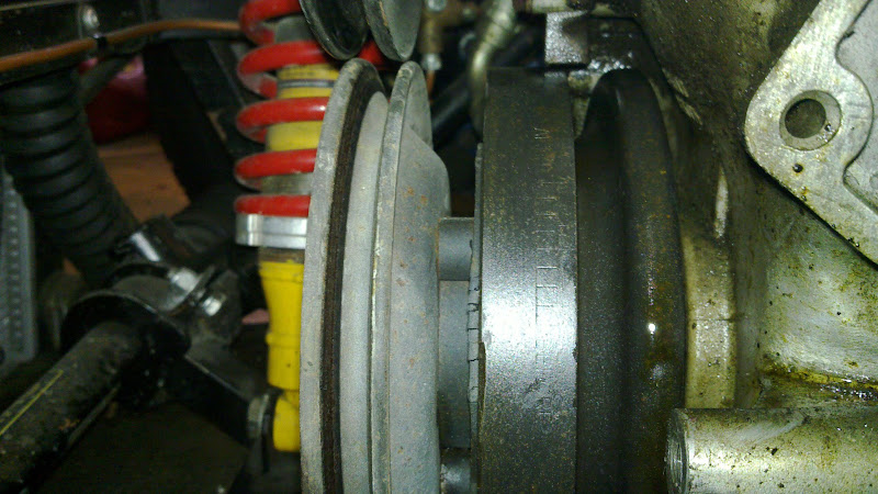

scudderfish
posted on 12/2/10 at 10:49 AM Reply With Quote
More progress. It turns out the captive nuts weren't. I heard the dreaded 'plink' as the first bounced across the garage floor. Oh well, worst case is I have to undo the FO nut to get it all back on, so I'm no worse off really. I ploughed on and got the pulley off. In the second pic above, you can see some spacers between the pulley and the damper. These fortuitously are the same size as my TW and a spacer, so it all fits together nicely.
What I need to do now it make up a bracket. There are a convenient pair of threaded holes on the left side.
However they are above the centre line (it was too much to hope for) so I'm going to have a funky angle in there to get the sensor at right angles to the wheel. Getting in there to measure that funky angle is a bit of a swine. I think I'll end up mocking it up in ABS or something similar so I can easily heat and bend as appropriate before making the real thing.
