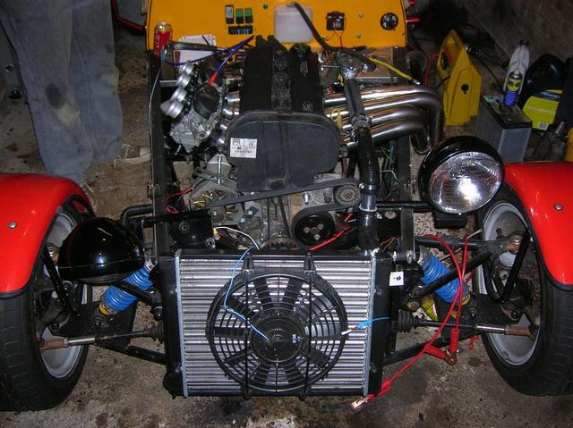

You can see my mounts on the front of the radiator. I wanted them small, light and stiff so made them from anodised U section from B&Q. The rad end of each mount is spaced with a piece of ally tube to butt the fan up against the rad.
[img][/img]
