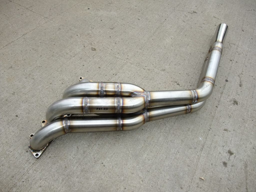

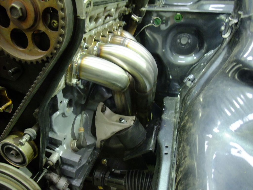

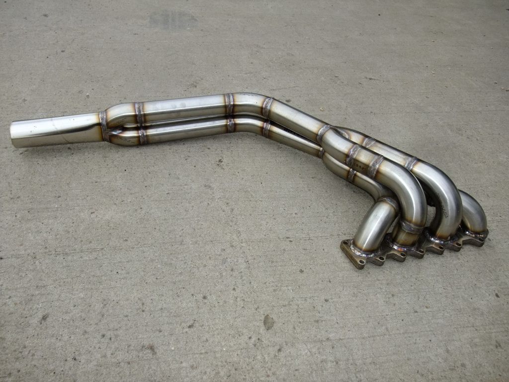

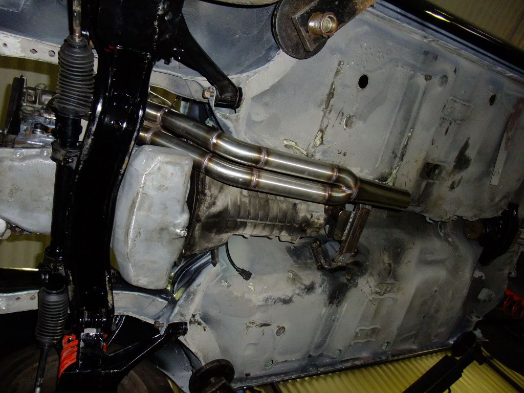

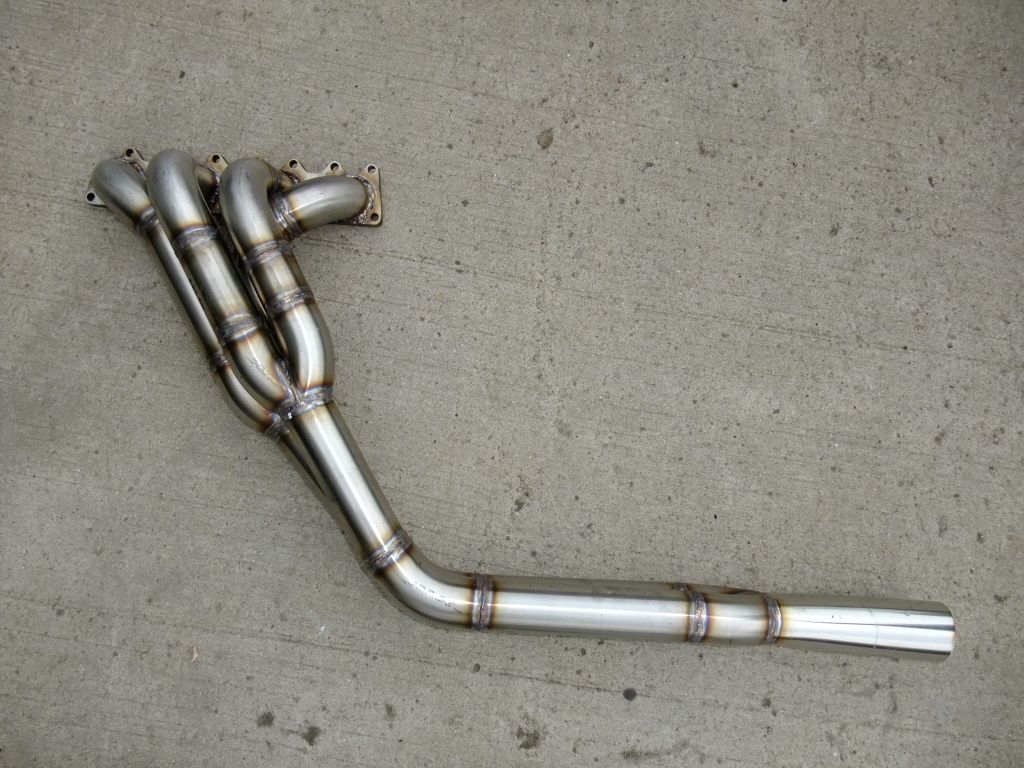

Been making manifolds again!
Not for a locost, but an XE that I'm putting in a Kadett C Coupe that we've been rebuilding for a customer, thought you might like the shiny bits!!

Love it
the collectors are
Build Blog
Build Photo Album
prawnabie
posted on 29/4/10 at 10:22 AM Reply With Quote
making something like that is all well and dandy, but making something like that that fit inch perfect is TOP WORK!!!

That's art
cd.thomson
posted on 29/4/10 at 10:29 AM Reply With Quote
im proud of my exhaust, but that is a very fine piece of work

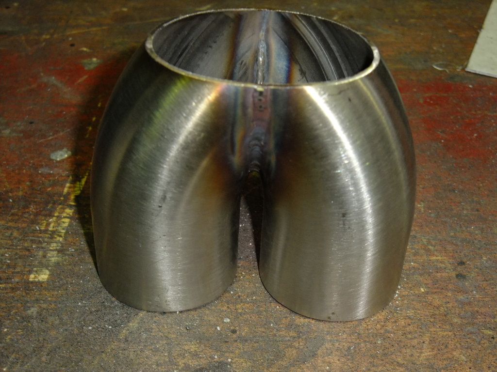

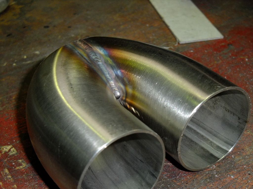

do you pickle all the welds up after???
i personally hate to see loads of joins in an exhaust system, also i was allways lead to beleive that the more joins you have the more exhaust turbulance is created causing a hinderence in power gains???
however its a lovely job there...nice one..

Do you purge the inside while welding to get the bore clean/smooth like that?
Yea, would be lovely to have a mandrel bender and eliminate a few welds, but I don't have £10k burning a hole in my pocket at the moment!
As for power, well with 2" primaries it won't be a problem! If anything they are a touch big for the lower end of the power range (say 200hp) they are more suited to 250hp range.
Main thing is the proper tubular collectors, the horrid sheet metal pressed ones cost lots of power where the pipes go in and out.
I can pickle the welds, though to be honest they just polish up without the pickle and I hate using the bloody stuff (hydrofluoric acid is pretty unpleasant!)
I will see what the customer wants on this one.
If my main line of work was manifolds I'd put a bit more effort in, but this is just filling a gap where nobody makes one for the job.

This one's £450

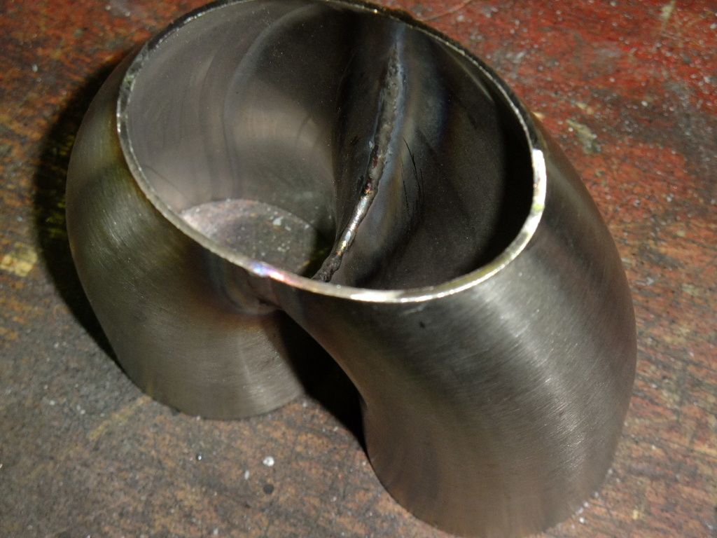

LOL I have a pro-tools bender but it wont bend the tube in the manifold that I started this thread about!!
I can do a bit and show you the result if you want!! It wrinkles it on the inside radius, and that is on a 7" rad die which is not tight enough for the header pipes!
