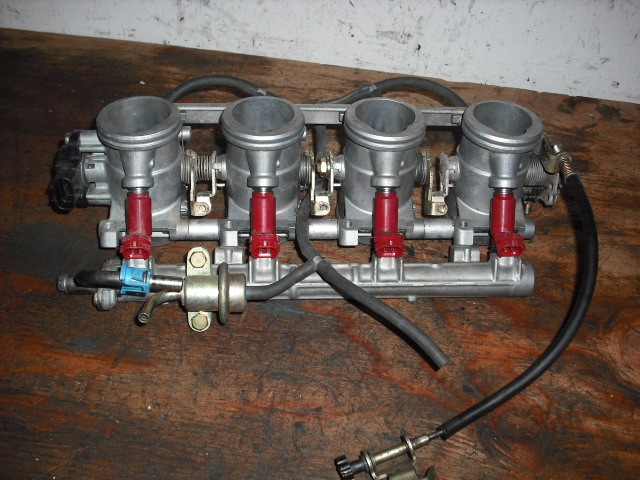

I used the ones big_wasa posted the ones with the red injectors on my zetec build
Simple to re-space ect .... They were from a 1999 GSXR 750 SRAD got them from the US for £50 postage want bad either
I blocked the injectors and have them on a ST170 Inlet manifold with ST170 fuel rail and injectors spent about half an hour cleaning them with some metal polish as i was re-spacing and they look mint !!!!
