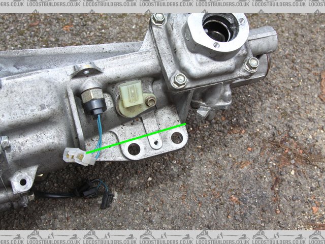

There are some mounting brackets on the gearbox that can be ground off, but I want to be sure it's going to fit before I ruin any chance of
selling it. This threaded hole at the front doesn't go anywhere, so I would grind it off. I'd imagine it's used for something like a
temperature sensor.

This mount was hitting the chassis rail, pushing the back of the box too far over.
It came off roughly along this line:

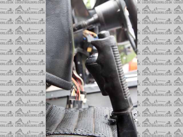

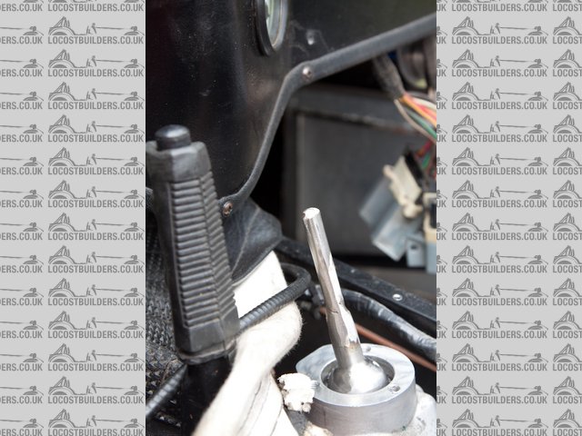

This shows the gear stick problem. The dashboard has a lump in the middle right where the stick needs to go for 1st and 3rd. My three options are a
new, flat dashboard; shorten the gear stick; put a bend in the stick so the knob is further back from the base. I sat in the car and tested the reach
but I think it's a little too far away to be comfortable over a long time. Bringing the knob closer by putting a bend in the stick seems the
best option to me. But I'd need to work out how to do it.

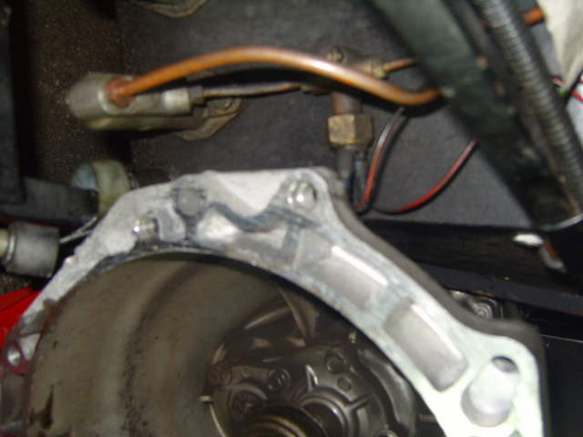

The MX5 uses a hydraulic clutch, but it has an external slave cylinder pushing a lever from the front. I'm planning on keeping my cable clutch
but I would need to make up a bracket to put the cable behind the lever in order to pull it. There's plenty of clearance to the bulkhead on the
passenger side.

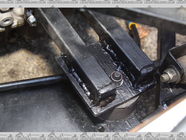

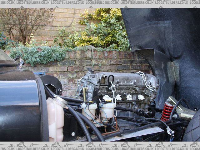

We worked on getting the engine into place. I eventually tacked up some engine mounts and I finished welding them today. They're not the
prettiest welds, but they should hold.
The standard sump has 3" ground clearance. Raceline are going to be about 4 weeks with getting some 10* short sumps in stock, so that will have
to wait until I'm back from New Zealand in June. The green line shows roughly where I think the shortened sump will come. I should have 4"
clearance to the bottom of the bell housing then.
This is my nice, strong transmission mount.
I'm trying to work out how to mount it properly. The bottom of the gearbox mount is almost level with the bottom of the car. I was thinking of
putting some brackets at the top of the chassis rail, then have some rubber mounts going downwards to a steel plate, which would be bolted into the
gear box. I could do with some suggestions on that.
The bonnet clearance is just right, although the cam position sensor is too high. The back of the gearbox will go down a little when it's
properly mounted anyway, so it should drop the back of the engine down.
There's a chassis rail at the front of the engine which might cause problems if the Raceline sump comes straight down.
Looking at this photo, it seems like it's just the timing chain cover that's above the rail. The car is all tucked away now so I
can't easily go and see in person.

I had a problem with the MX5 gear box in that the gear stick was hitting the dashboard. I was trying to think of how to work around it because the MX5
stick has a thick top section pressed onto a narrow bottom section. You can see the thick black part on the photo higher up in the thread. It occurred
to me that I could just chop the stick off at the base and weld a steel rod onto it. So that's what I did.
Cut near the base to keep the ball joint:
Ground it down to be fairly smooth (It will be hidden under a gaiter anyway)
Trial pitted:
My fingers still make contact with the dashboard but the knob will need to be pressed down about a centimetre more once it's all sorted, and
that should give me enough clearance.
