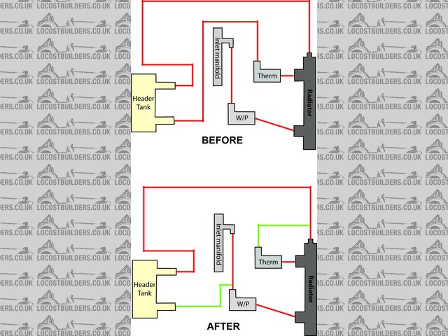

I am having some issues with my cooling for the 2.0 Pinto. I have searched much on the forum and after looking at many options, I think mine is wrong.
I have fitted a CBS adjustable 'in-hose' thermostatic control for the electric fan, and have fitted a matching guage and sender for the
water temp. I have the fan set to come on at around 80deg at the moment because the temp was going up to just over 100deg and looked like it was still
slowly climbing . So I set the fan to come on before it reached that temp.
Problem is, I don't think that the fan is really doing a deal even though it is sucking air through the rad nicely. I have a feeling that there
is not enough water going through the top hose to trigger the fan and it also feels as if there is more air than water in the upper hose. I tried
running with the cap off to bleed some air out but I think my fundamental setup is wrong.
The 2 pics below show the system as it is now and how I think it should be.
  Cooling
Any input welcome guys
John

loggyboy
| posted on 13/3/12 at 05:24 PM |
Diagram isnt that clear about pipe diameters from header, and which is top of rad etc.

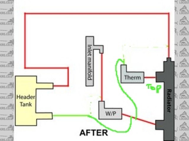

loggyboy
| posted on 13/3/12 at 05:31 PM |
here is how I would do it:
  PintoPlumbSuggestion

Daddylonglegs
| posted on 13/3/12 at 05:44 PM |
Sorry
Radiator and Header are 'correct' way up, i.e top is top etc. Radiator has small connection on top opposite side to upper large hose.
bottom hose is also the large (about 50mm IIRC).
I have added a couple of pictures of the actual car to help.

I run a 2.0 pinto and have NO cooling issues whatever. This subject HAS been dealt with previously and I have copied it below as per my post on the
subject
Copied bit -------
I tried it like you have posted and it gave me problems so this is what I ended up with
Rad lower to water pump - YES
Rad Upper to thermostat - YES
Water pump small to ( bottom of header tank - NO ) Goes to small on inlet manifold.
Inlet Manifold to ( top of header tank - NO ) Goes to small water pump.
Small thermostat port ( blanked off. - NO ) bleed pipe from top hose goes to top header tank/bottle collecting Via a 'T' piece the bleed
off the top of the thermostat return to top of header tank/bottle.
Bottom of header tank/bottle should go to a 'T' piece cut/spliced into bottom hose.
Also, IF you have a bleed pipe on the top of the radiator, then this should be 'T'ed into the bleed pipe off the top of the thermostat.
-----------------End copied.
the link to the post is as below
Linky dinky to PINTO COOLING.
Basically both of your cooling layouts are wrong and will give inherent problems with fill/cooling/operation.

britishtrident
| posted on 14/3/12 at 08:43 AM |
There are a few ways of connecting but the really important thing is to get the coolant circulating even when the thermostat is closed.
This is for several reasons first of all the thermostat will not work properly unless hot coolant can get to and around the thermostat bulb even
when the engine is cold and the thermostat closed and to allow coolant to circulate between and within the head and cylinder block to avoid the
formation of hot and cold spots within the engine.
Pinto thermostat housings differ in design if the thermostat housing has a small diameter outlet or outlets this should be connected back to a
water pump inlet or the bottom hose, this can be via a header tank ie into top of the header tank and bottom of header tank connected to the
bottom hose via a tee.
The main by-pass for circulating coolant should come from the outlet for the heater on the head back to the water pump.
A small hole drilled in the thermostat will aid bleeding the system and provide an extra by-pass flow that will make the thermostat respond
faster, however if you have too many/too large holes it will make the coolant take a longer time to warm up.
If you don't have a small bore by-pass connection on the thermostat housing multiple holes in the thermostat will allow the thermostat
to work properly BUT it wif this is the only by-pass flow it won't provide enough circulation within the engine to avoid hot and cold spots
forming in the block and head.
The job of the electric fan is to control the radiator temperature not the engine temperature, it should be ideally fitted either in the radiator,
both the fan switch on and off temperature should be above the thermostat start to open temperature.
[/I]
Daddylonglegs
| posted on 14/3/12 at 09:25 AM |
OK, thanks for all the input guys.
So, from what I can tell, (if I got this right), the only difference between Jolly's and Martin's is that Martin has no connection between
the manifold and pump top connector, only a bleed in the manifold and blocked at the pump?
(Martin, I assume you have the large connection from the Thermostat housing to the radiator top hose and the small connection on the stat housing to
the radiator bleed (small) connection on top?)
If I got it right, I just need to change mine so the bottom hose from exapnsion tank to stat small needs to be changed to a 'T' in the
lower rad hose, and the small stat connection 'T'eed into the ET top hose to radiator small bleed connection?
God! how can a simple cooling system be so damn difficult to understand??
JB
britishtrident
| posted on 14/3/12 at 06:15 PM |
Sounds good to me.
[/I]
Daddylonglegs
| posted on 14/3/12 at 07:29 PM |
Well, managed to get a 'T' into the bottom rad hose and connected up as above. I need to get a 'T' for the top connector to
rad small bleed connector and stat small connector. At the moment, I just left the small rad bleed open and ran the car until it started spitting
water out of there then just closed it off with a stub. Seems to be working fairly well, engine temp gets to about 95deg on gauge, fan cuts in at
about same (set for 85deg), cuts out when temp drops to about 90deg
That's the good news, but the bad news is....
