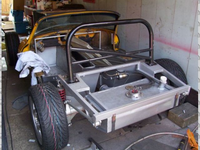

welderman
posted on 5/7/12 at 11:26 PM |
I made my own too
Thank's, Joe

welderman
posted on 6/7/12 at 09:20 AM |
quote: Originally posted by welderman
I made my own too
![](/galpreviews/tank...jpg) ![will tank fit ?.](/gallery/tank...jpg) will tank fit ?.
![](/galpreviews/Image192.jpg) ![ally tank](/gallery/Image192.jpg) ally tank
![](/galpreviews/Image191.jpg) ![ally tank pump boss](/gallery/Image191.jpg) ally tank pump boss
![](/galpreviews/Image190.jpg) ![ally tank](/gallery/Image190.jpg) ally tank
Thank's, Joe
