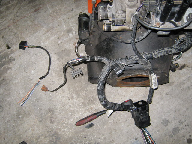

Now the next bit, fitting the wiring harness from the Blacktop to the Silvertop. The ECU is an EEC-V module called NECK, I have the key and the
sensor ring that goes around the barrel, but need to confirm the pin out and overall connections.
Most of the engine bay wiring is sorted as the connectors would only go on to the correct sensors. (Why two temp sensors on the thermostat
housing?)
I have to extend the Idle control and TPS wiring to reach the units and extend the crankshaft 36 tooth sensor from the back to the front of the engine
to fit a CVH pick-up.

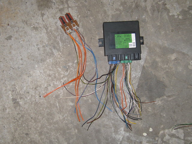

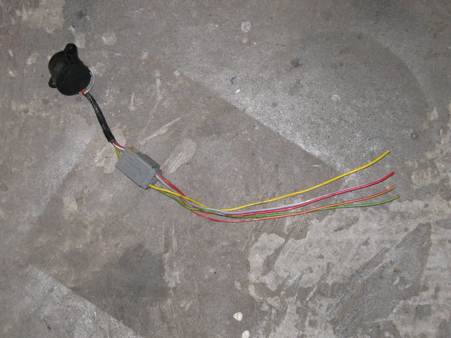

I am left in the engine bay with one 5 way plug with two wires in it which I am unsure of with Purple and Purple with white stripe wires
I also have a separate module from under the dash that says 98 AG 15K600FB which says it is a control link and Alarm system module. I am not sure if
this is connected to the PATS system or if I can leave the unit out.

Black box with lots of wires is the alarm = In the bin, not needed.
5 pin mini timer housing, two purple wires = reverse switch plug.

The pin outs are here:
No. Main Colour Stripe Notes
1 Green Blue Thick Wire
2 White Blue
3 Black Orange
4 Grey
5 Black Blue Same as 6?
6 Black Blue Same as 5?
7 White
8 Green Black
9 Black Green Thick Wire
10 Orange yellow
11 White
12 Blue
13 White Purple
14
15
16 Orange
17
18 Black Orange
19 Purple Black
20 Black Blue
21 Yellow Purple
22 Purple Blue Same as 23?
23 Purple Blue Same as 22?
24 White Red
25 Black White
26 White Red
27 Black Yellow
28
29 Black Green
30 White Black
31 Purple
32 White Orange
33
34 Purple Black
35 White Green
36 Black Yellow
37 Purple
38 Brown
39 White
40 Black Blue
41 Purple Orange
42 Purple White
I appreciate your help on this.

You are in luck. It compares very very well to the 2.0 mondeo of the same age and ive done a few of them.
There are some of the below that you wont need or want. There are some pins that I have no info on. They may or may not be conected all the way
through. ie they may be dead links. If they do conect to the ecu I could look the ecu pin number up on autodata.
here you go, a couple of hours latter,,,,,,,,,,,,,,,,,
warren
quote: Originally posted by AdrianH
OK thats good I have them sensors from the Blacktop
No. Main Colour / Stripe Notes
1 Green Blue Thick Wire -- switched live.
2 White Blue -- Data link connector.
3 Black Orange
4 Grey -- Data link connector.
5 Black Blue -- Fuel pump relay earth.
6 Black Blue -- Pats led earth.
7 White -- Power steering pressure switch.
8 Green Black – Alternator charge light.
9 Black Green Thick Wire -- earth.
10 Orange yellow -- Memory, permanent 12v.
11 White
12 Blue -- Data link connector.
13 White Purple -- Vehicle speed signal to dash.
14
15
16 Orange -- Alternator 12v monitor.
17
18 Black Orange -- Evap canister purge.
19 Purple Black -- Fuel pump monitor.
20 Black Blue -- slow fan relay. (Ac).
21 Yellow Purple
22 Purple Blue -- Fused switched 12v O2.
23 Purple Blue -- Ac pressure switch.
24 White Red
25 Black White -- Fast coolant fan relay control.
26 White Red -- Dash coolant temp.
27 Black Yellow -- Ac clutch relay.
28 -- Trip computer.
29 Black Green -- oil pressure switch output.
30 White Black -- Tacho output.
31 Purple -- switched 12v for coil / suppressor.
32 White Orange -- Pats.
33
34 Purple Black -- Reverse switch .
35 White Green -- Pats
36 Black Yellow -- Starter motor relay earth.
37 Purple
38 Brown -- Sensor common earth.
39 White -- Clutch pedal signal.
40 Black Blue -- Ac pressure switch.
41 Purple Orange
42 Purple White -- reverse switch.
Adrian
[Edited on 24-8-12 by AdrianH]
