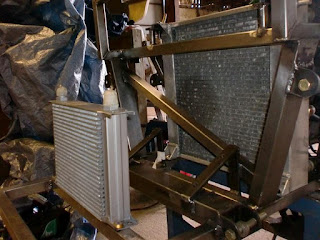

beaver34
| posted on 5/1/13 at 09:48 PM |
Space is an issue in mine as yours I presume?
You can just see mine in the pic behind the rad

beaver34
| posted on 5/1/13 at 10:33 PM |
Yes fine, allways ran it there when it was n/a had no issues
