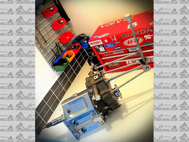

thought I would post a few pictures of my new sequential gearbox. Took my car to Spa earlier in the summer and couldn't get out of 4th gear on the Kemel straight!! (currently running a standard ford type 9 gearbox.) When I got back I managed to source a secondhand sequential box with new internals at a very reasonable price. The advantanges will be less weight, faster changes, and the fact that I have been able to tailor the ratios.
The new box is an Elite IL200 - 5 speed sequential, with reverse. My box is I think a very early development box, hence the billet aluminium maincase. The box and current shift mechanism weigh in at 23.6 kg dry (only takes 1 litre of oil).
As I'm going to all the bother of taking the engine and box out I thought I may as well go to town on the rest of the driveline, so purchased a billet flywheel with integral ring gear from Turbosport and a 7.25" clutch assembly from Mardi Gras motorsport. It will be interesting to see how this changes the character of the engine (currently standard flywheel, 4 paddle clutch standard diameter, ~185 bhp). My use of the car is 70% track, 30% road.

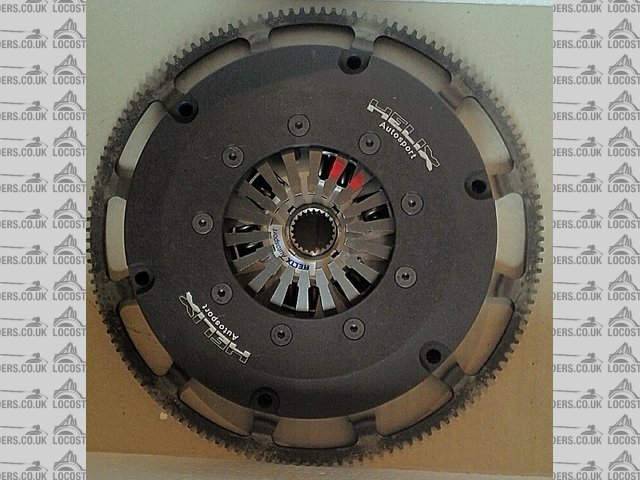

weights for those interested:
flywheel 2471 g
4 paddle sprung centre friction plate 1112 g
complete clutch cover assembly including bolts 2424 g

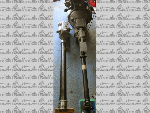

The box will fit straight to my bellhousing at the front end so that is all good, however the back end of the box is totally different to a Type 9 as you can see here:
the box is shorter, and needs a flange mount to the front of the prop as well as the rear. First question: Can anyone suggest any companies where I can either get my current prop modified or a custom prop made?
Second question: is anyone on here running a carbon prop? I know quite a few people on blatchat are running them on Caterhams now. I'd be interested as it reduces inertia and in failure is a bit safer than a steel shaft!!

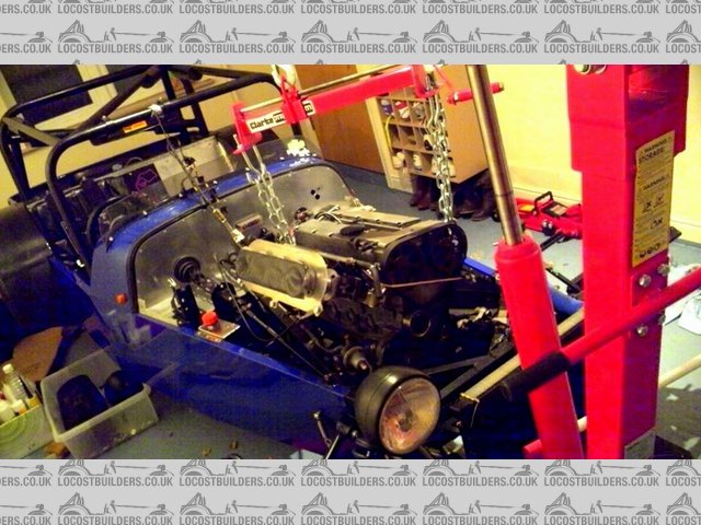

apologies for the lack of updates, however I have been busy getting the engine out and getting everything together required to swap the box in.
Due to the box being extremely short I have had to custom make a propshaft, and decide to go Carbon Fibre for a number of reasons.
I have seen quite a few propshaft failure threads on Blatchat and in race Caterhams, and when a steel prop lets go it makes a hell of a mess not only of the centre of your car but potentially of you and your passenger's legs.
With a carbon prop, if something goes wrong they generally shatter or broom, and don't have the energy to exit the transmission tunnel.
didn't fancy paying £1200 for a CTG torqline one so have elected to design and make my own, using a factory RX8 prop (carbon from OEM) as a base (I am an Automotive Powertrain design engineer by trade). Due to the diameter, and the need to flanges on both ends, the prop has to be fitted to the rear diff before the engine and box can go back in. I hope to have this done within the next 4 weeks.

engine coming out:

new flywheel & clutch fitted:
measuring up for bonding the new prop ends:
The way I see it is I have nothing to lose. This is all a bit experimental but if it doesn't work and fails, I will just have a custom steel prop made up instead
If it does work I am on for a 30% weight saving on the prop, despite it being longer. And potentially there are some benefits of running an OEM part where Mazda will have tuned the torsional stiffness of the shaft. Not something we normally bother with in kit cars, but could help to reduce driveline shunting - in 1st gear especially.

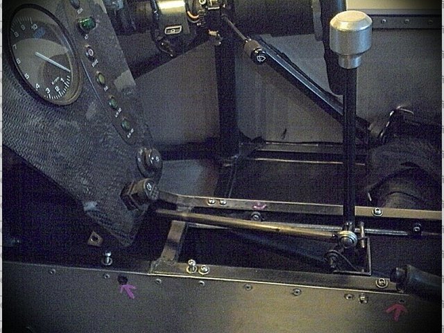

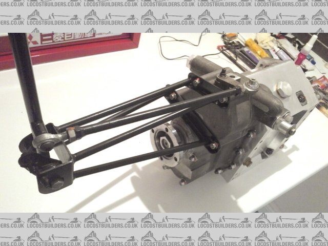

Yes the gear linkage will have to be totally custom, I have now chopped off the arms you can see here:
and I will be bolting or welding the sprung lever mechanism directly to the transmission tunnel, further back in the cockpit (even with the 5" extension the Type 9 lever was a bit far forward for me). Then I will fabricate a custom linage between the lever and the box.
The other problem you are faced with on these boxes is they have a plunger for selecting neutral/reverse. I am going to use a cable puller to activate this, maybe with a lift-collar on the stick if I get fancy with it!

Thanks for the pic Pat, it actually looks really easy now ive seen it. I may invest when ive got more spare cash next year now.
Good luck with the install, it will certainly make for a quicker car on track.

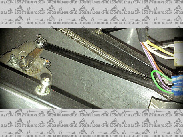

Most recent progress has been fabricating a gear linkage and reverse mechanism:
linkage bar made from 12mm carbon fibre tube with two M8 rod ends bonded in. Lever mech set back in the tunnel and slightly to the passenger side so that shift knob falls close to steering wheel, without getting in the way when winding on lock
I have had to cut hole through bracket which supports the dash for linkage bar. Will also have to cut a hole in the new transmission tunnel top panel (will be carbon fibre but not ordered material yet...)
shifter arm.
