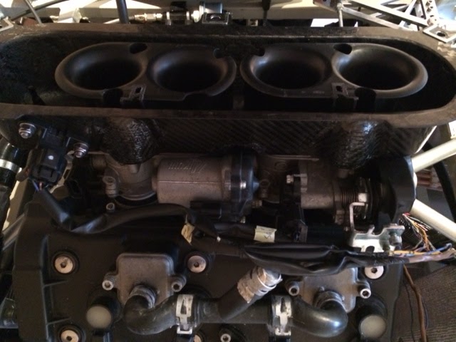

I forgot to say, on (6) I have dumped the variable inlets as you won't use them at all at racing revs. My natty carbon filter tray looks like this:
http://2.bp.blogspot.com/-L4sgQOvC7cU/Uy_esQ088KI/AAAAAAAAC3o/-FLg73SBRj4/s1600/2014-03-24
