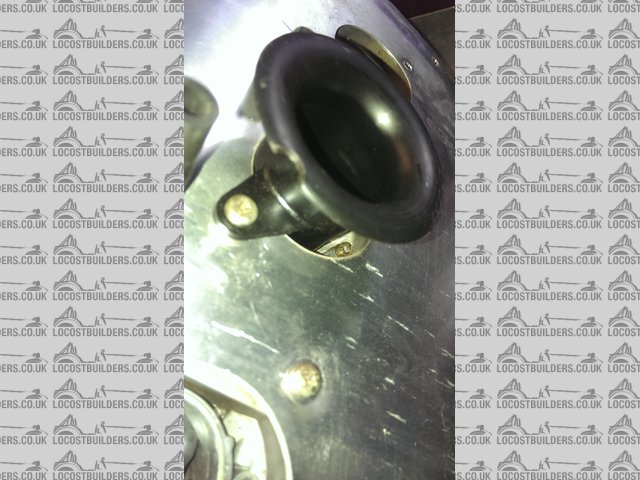

| posted on 12/5/15 at 04:01 PM |
quote: Originally posted by r1_pete
Thanks for that - I've been looking for that diagram but couldn't find it. So potentially I could b seeing 5% more airflow.
I've just been out and drilled a set of mains to 1.9mm and put it all together, complete with airbox - running around 14-15.5AFR at WOT.
Will try opening out to 2.1mm and see what happens.
Some pics of the setup with/without trumpets below -

MikeRJ
| posted on 12/5/15 at 05:05 PM |
Possible theory:
Without trumpets the air drawn in to the main choke will be passing over the top of the air corrector jets. This fast moving air will create a low
pressure in front of the jets which would prevent or reduce the amount of air entering. This would create a rich condition, and in fact many people
using bike carbs on car engines have had to block off the air correctors to get the mixture rich enough.
With the trumpets on the air correctors will now be in still air (as they should be), allowing air to be drawn in and emulsified with the fuel,
weakening the mixture.
Have you tried with only the trumpets fitted, and no back plate? If the mixture still weakens off then it would add weight to the air corrector
theory.

I tried the car again today with 2.1mm mains and it is definitely better now in the 12-14AFR range. Looks like I need to go bigger again so will try
2.3mm. I dread to imagine what the fuel economy will be ....
I'm also no expert but surely if you keep making the mains bigger at some point you will need to get different needles as they will be too thin
to close the main jet at tickover / low throttle openings?
I'm really surprised a 2.0 Duratech would need jets so much bigger than a 2.0 Zetec on the same carbs. at 1.6mm mine are on the rich side at
WOT.
If you were closer I'd lend you my spare carbs to try as I think something isn't right.
BTW I have none of the air correctors etc. blocked on my carbs.

davidimurray
| posted on 16/5/15 at 10:09 PM |
Just to update - drilled out the mains to 2.3mm today and then took the car out for a test which turned into a 2 hour long hoon!
Fuelling is much better now, see below but WOT is now in the 12s. Despite the big mains fuel economy doesn't seem to bad soa far - on my 75mile
test run it averaged 27mpg.

dave_424
| posted on 16/5/15 at 10:13 PM |
WOT wants to be around 12.5
Looks pretty spot on

whitestu
| posted on 17/5/15 at 08:33 AM |
Is that with the trumpets and filter back on?
Looks good.
