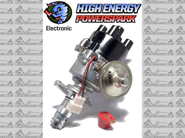

In my efforts to get my engine running sweet I have found out that I have a different dizzy. ( Is that a "diffy" ? )
I've come across an electronic dizzy for my engine and wondered if anyone has fitted something similar to their power plant?
Cheers Paul G

| posted on 7/6/15 at 10:52 AM |
My trouble is Pete that I couldn't fit a Megajolt. Wouldn't know where to start, and I certainly wouldn't be able to set it up.
The Powerspark spec says "matched to all 4 cylinder Lotus 907 engines including Eclat, Ellite," etc etc. (Mines from an Eclat)
It says it needs a lower resistance coil and just two wires to connect. (And presumably set timing) Coil & Dizzy = £79.95
I think I could manage fitting that.
Thanks for the reply
Paul G

| posted on 11/6/15 at 05:53 PM |
the lotus elite / eclat S1 had a lucas 25D dizzy fitted from the factory. from 1976 onwards a 25D4
S2 cars hat a 43D, the excel se a 45D
the early cars had points fitted, the later ones (but dont know from when) came with a point-less dizzy already from the factory
as the dizzy fitted is damaged i would go for a replacement...maybe you can ask the guys of accuspark if their dizzy´s have the following advance
curve:

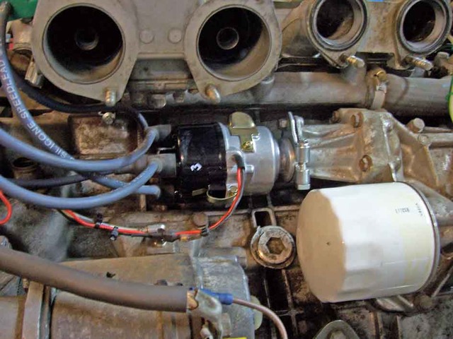

907
| posted on 18/6/15 at 06:42 AM |
I'm back again.
I've had a chat with the tech help section of Powerspark and they say that the spec 5 (see chart in previous post)
is the way to go. No vacuum advance with this one.
I have bought it and am in the process of fitting. The pic shows the dizzy with one carb above. With the second carb
on and the throttle linkage and air filters on, if you can imagine that, you can see why I'm not keen on adjusting points
every few months. I did have to buy a matching low resistance coil as well.
On the non-electronic front I have found out that a dizzy from an MGB GT 1800 is the one to use.
It has the same advance curve as in the Lotus data sheet so if points and vac advance is better, or the electronic
dizzy fails, then at least I have another option. I've been offered a "good second hand" one for £25 so I'll get it and
keep
it as an alternative.
I'll try to pinch a couple of hours today and fit the carbs back on, and with fingers crossed, turn the key.
