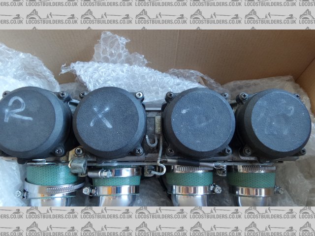

| posted on 23/2/16 at 09:59 AM |
  Bike cars marx175
Can see tops on sunlight in wrong order but seem to be zxr750.
[Edited on 23/2/16 by Marx175]
mcerd1
| posted on 23/2/16 at 10:23 AM |
Looks like something a bike breaker has written on them, then they probably got mixed up when they were serviced
But that assumes that they haven't had the caps swapped with another set of carbs.....

Marx175
| posted on 23/2/16 at 10:36 AM |
Thanks will let you know what happens.....
FASTdan
| posted on 23/2/16 at 11:46 AM |
I suspect they are ZX7/750 carbs, or ZZR1100. The throttle linkage in the middle rules out early ZX9R and ZX6R, the lack of a TPS rules out all the
other ZX9R carbs.
The internal diameter at the manifold end should be 38mm and the spacings 78-87-78mm if ZX7. However if they are 40mm and spaced 75-86-75mm then they
are ZZR1100.
All the same basic carb.....

| posted on 23/2/16 at 05:45 PM |
38mm inlet holes.😊
