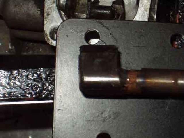

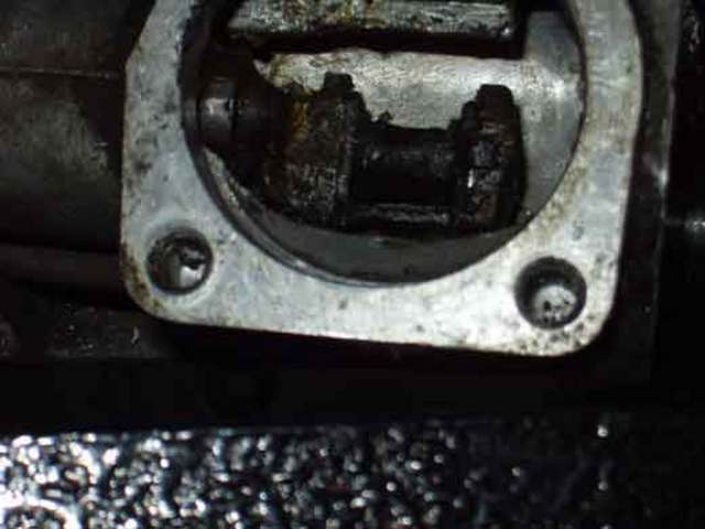

It looks like the fork thats meant to slot into the gearbox selector shaft is too big, i have hopefully attatched some pictures below.
[img]/upload/PB070004.jpg[/img]
[img]/upload/PB070007.jpg[/img]
[img]/upload/close-up-of-gearbox.jpg[/img]
I think probably the bit of the selector shaft that swivels when you move the lever from side to side should come off some how and then the westy
remote will fit but i don't know if it comes off or not.

There is a black plastic "clip" for want of a better word that is on the selector shaft. If you clean more of the greese off you might see
it easier.
Remove the black plastic thing.
Fit westy remote from the rear (where you've removed the plate).
Fit the plastic bit onto the selector shaft on the Westy remote.
Fit the gear lever to the westy remote.
Job done!

I can see it !
But how do i get it off.

Get a screwdriver under the edge of it but be carefull, I snapped a bit off mine whilst removing it, but it still works.
It sort of clips on, but I can't 100% remember I fitted mine about a year ago!
Just fiddle with it till it comes off

I feel stupid now as clip came straight off, didn't realize it was plastic and that it was just sitting ontop of the shaft.
