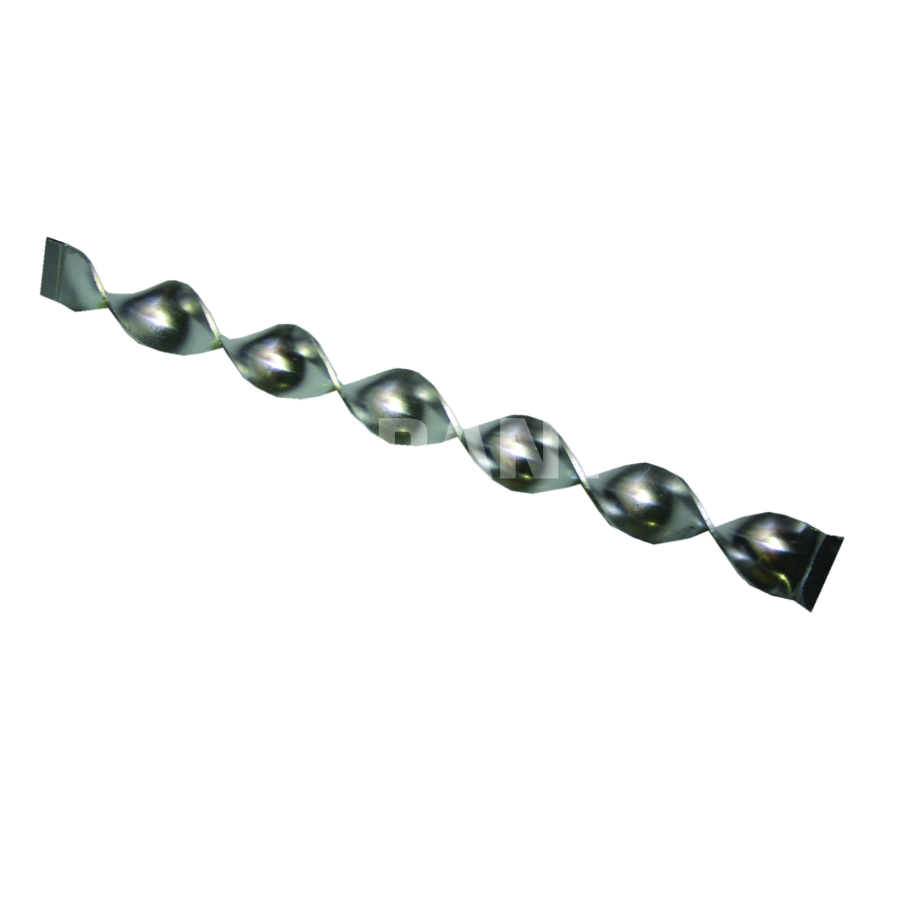

I was also going to try a spiral baffle within the perforated pipe first, which should break up the pulses but not increase the backpressure
significantly.
Something like the following picture:
https://www.grantuk.com/media/2414/vbs05.jpg
I don't know how significantly this might affect the power but is worth a try if I can find a source of the correct size spirals, or a way of
making them. I guess they are drawn through a die, but I might be able to do similar with the lathe and some parallel rollers.
I have previously used a universal dB killer insert (also at llandow at a previous visit) which worked for the noise, but it absolutely sapped engine
power, i was loosing about 10-15mph on the straight.
significantly.
Dave
I actually have something like this already but I have never used it. I'm going to see a fabricator tomorrow to see what they can do to mount it
as it's my best bet
The spiral, albeit fixed may also do something.
