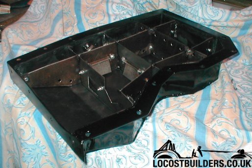

posted on 15/6/05 at 03:05 PM |
Heres a few shots of an alloy baffled 5 ltr low profile sump for my 4AGE "Blacktop" 20V motor.
I just bought this from BPJ Services but isn't cheap or particularly light. The factory windage plate is retained.
![](/galpreviews/sump 001.jpg) ![Zetec sump Modded by Deneo 1](/gallery/sump 001.jpg) Zetec sump Modded by Deneo 1
![](/galpreviews/sump 002.jpg) ![Zetec sump Modded by Deneo 2](/gallery/sump 002.jpg) Zetec sump Modded by Deneo 2
![](/galpreviews/sump 003.jpg) ![Zetec sump Modded by Deneo 3](/gallery/sump 003.jpg) Zetec sump Modded by Deneo 3
[Edited on 15/6/05 by bimbleuk]

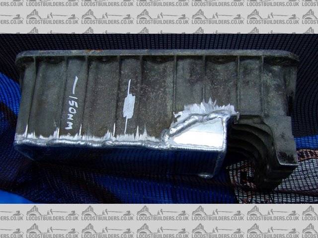

CairB
posted on 15/6/05 at 07:23 PM |
Mines a bit cruder, but probably a bit cheaper.
[Edited on 15/6/05 by CairB]
bimbleuk
posted on 15/6/05 at 09:34 PM |
CairB,
You made it your self so its a true locost sump!
Anyway looks perfectly decent to me and probably a lot lighter too. I was going to wait for RAW to fabricate from steel but my current sump wont last
much longer from the looks of it.

CairB
posted on 15/6/05 at 09:47 PM |
bimbleuk,
Thanks for that.
I was in the garage thinking mmm lowline sump on the one hand £450, on the other £0 but a lot of sweat... no contest
It doesn't weigh much different to the aluminium floor scraper that came with the engine.
As I've managed to ground it on an unsuspecting sleeping bobby I'm glad I did it with this and not an ally one.
Colin
bimbleuk
posted on 16/6/05 at 05:15 AM |
Yep the partitions and gates are made from steel.
I do the odd bit of computer work for a few automotive companies so I usually get things at trade. Otherwise I would had thought twice about spending
£375+VAT on a sump!
[Edited on 16/6/05 by bimbleuk]
