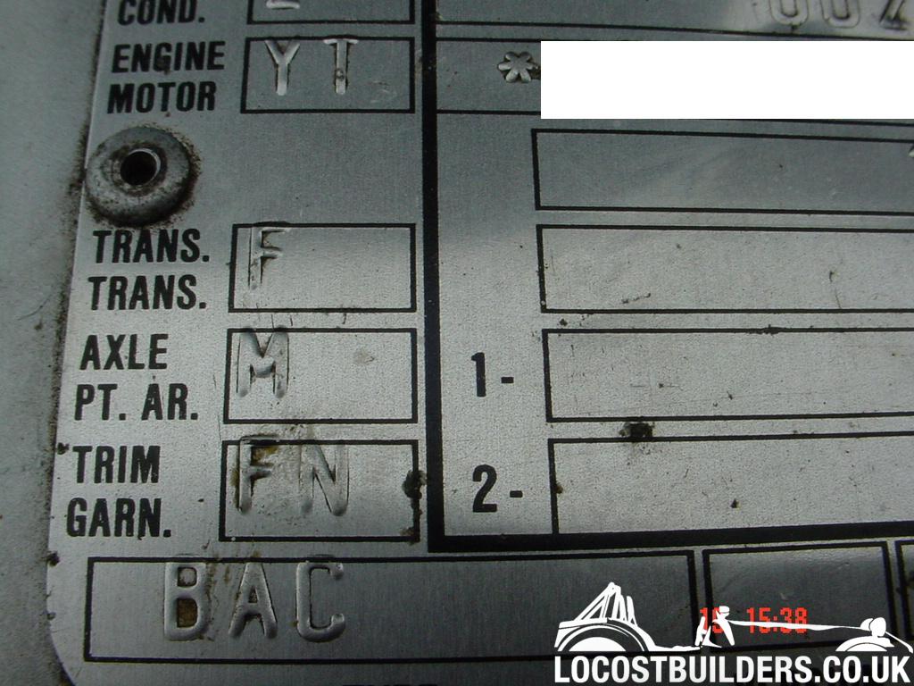

Hi everyone, i have just aquired a diff and attached sierra diesel 2.3 and have been looking around for any means of identification...
On the VIN plate in the box labled "axle pt. ar." i have the code "M"
On the diff tag itself i have the code
B 3BG4006 KC
4A 314 3C18
So my question is; Is this a diff with a ratio of 3.14 ?!, seems to be the case so far!
Check the pic ! ->>>>VIN plate of car
Cheers!

Box 10 - Axle
M=3.14
A=3.36
U=3.38
V=3.62
3=3.64
D=3.92

There is an error in the codes above. Should be as follows
V = 3.38
U = 3.62
Certainly looks like you've acquired a 3.14
Congatulations

i think the Y plate is the key, the age. All newer ones seem to be 3.38, including estates and models with towbars. Well done!
Incidentally, the easiest way to check if the car has its original diff is to check the speedo against another car - when the diff changes, the speedo
starts to read wrong, i believe the output on each gearbox is specific for each ratio of diff.
and hellfire is correct about the code errors, i found out to my cost! easy to remember which go together by the 'AV' cable. Not AU for
gold...
