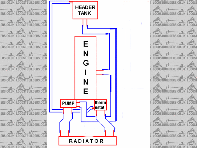

| posted on 8/9/05 at 06:19 PM |
Either air in the system or connected up wrong. Don't think not having a 'stat should cause all that to happen.
How is it all plumbed in?
This is how mine was fine.
Pat...

john_p_b
| posted on 8/9/05 at 07:27 PM |
the system is piped up exactly as in pats diagram but without the heater. i've taken some pictures of the pipework so i'll post them up
later.

| posted on 8/9/05 at 08:47 PM |
Mine had a similar thing a couple of months back and the thermostat gasket was the only thing at fault, all I could find anyway. I have the same basic
setup with a 2.0 pinto.
