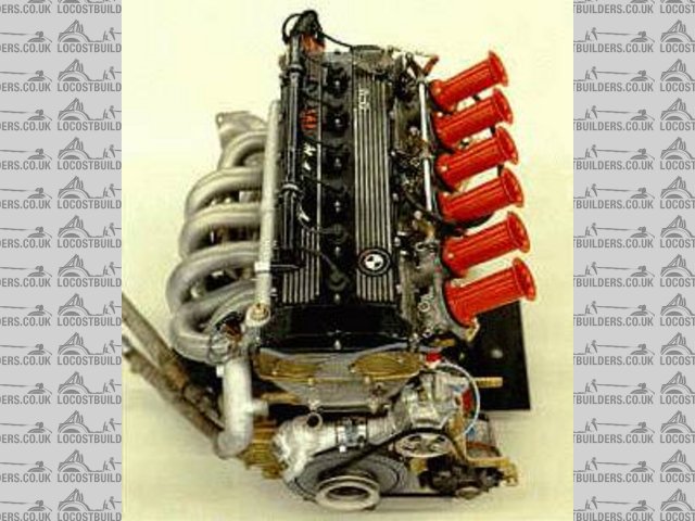

| posted on 6/2/03 at 11:06 AM |
I've got a pic of the old M5 engine, dunno how standard the trumpets were though.
Thought you'd be interested...
President of the Non-conformist Locost Builders Club. E-mail for details...
