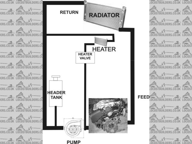

posted on 18/12/05 at 02:22 PM Reply With Quote
Here's my draft layout - the heater will be fed by a single 15mm pipe directly from the pump (as there is no thermostat)

posted on 18/12/05 at 02:48 PM Reply With Quote
Raz man - Yes, the bleed is from the top of the rad all the way back to the top of the header tank.
You can see it in some of the photos in the thread link below, as I posted in your thread re alloy/rubber pipes.
I also used a swirl pot , with the top bled back to the header tank.
This layout is as recommended by Carrol Smith, in Prepare to Win and Engineer to Win (if anyone else has those books did you notice how the two diagram's differ? - seems Carrol changed his mind between writing the two books)
Most important point - put the header tank as high as possible. The header tank cap is the only opening I have in the system.
Another point that that he makes, and that makes sense to me, is to have a restrictor in the engine outlet, to keep the block pressure up. On most engines this is usually the thermostat, so I have retained mine, but with three 6 mm holes drilled in it to allow some flow when it is closed.

tadltd
posted on 18/12/05 at 03:01 PM Reply With Quote
The feed should go to the top of the radiator, and the heater 't'd' into the feed (to get the most heat from the coolant). The heater will also act as a small heat exchanger meaning there's less heat in the coolant at the radiator.

posted on 18/12/05 at 05:46 PM Reply With Quote
Fred, I know that Davies Craig recommend taking out the thermostat when using their pump but the heater will probably take ages to warm up so I was considering inserting one in line too, also with some extra holes, to keep some flow going. Now you mention it, it makes sense to keep some block pressure so it looks like a thermostat is a good idea all round.
The header tank will go in almost the same position yours is mounted and I will incorporate the bleed tube which also makes good sense. I'm not sure about the swirl pot so I will see how things go and test the system when the car is running.
Steve, I was under the impression that feeding the top of the rad will encourage air locks. My diagram shows it fed from the bottom with the heater tee'd from the pump to maximise on pressure to get the heater warmed up quicker (it's a theory anyway) The Duratec has a separate water jacket around the oil filter which I have taken out of circuit for simplicity but I might re-use it if I feel the need - I would put this in the circuit between pump and heater to get as much heat as possible, shutting it off with a valve (also in the feed) when not required. I can then use the heater for cold air flow in the summer.
Here's my revised version - now in glowing colour
