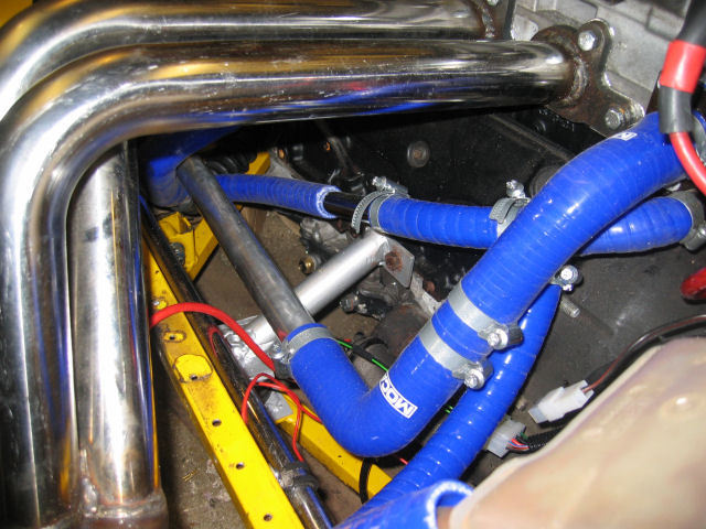

Does this help?
![](/galpreviews/WaterPipes.jpg) ![Zetec Water Pipes](/gallery/WaterPipes.jpg) Zetec Water Pipes

Only change I need to make to mine is to plumb the header tank into the lower rad hose - at the moment, the pressure of the water causes it to rise up
into the tank. Plumbing directly into the lower hose should put it into a suction state.
