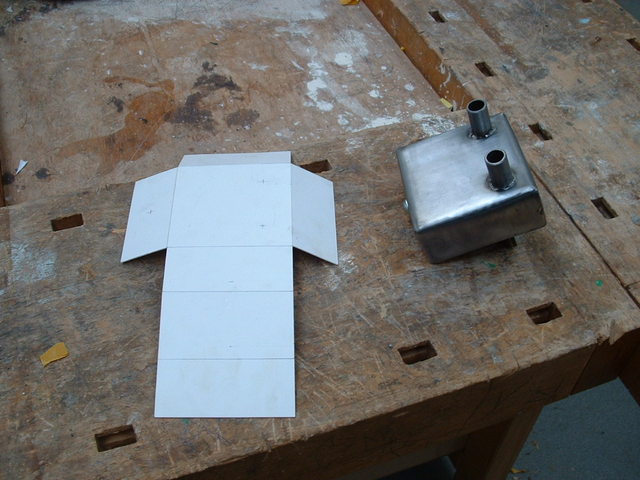

| posted on 18/1/06 at 06:44 PM |
made my own from a folded up flat sheet of steel, oh then got it chromed
"just like that !"
ayoungman
| posted on 18/1/06 at 06:45 PM |
sorry, I tried to get the picture bigger but it wouldn't av it !
"just like that !"
