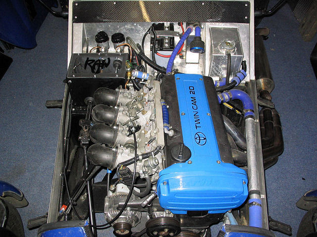

| posted on 15/3/06 at 07:32 AM |
Regulars on here have a good idea which engine I'll be recommending
For a relatively straight forward buy and bolt in then consider the Toyota 4AGE 20V engine.
Light weight compact engine which has proven to be reliable on track and very driveable on road.
Comes fitted with individual throtle bodies and Toyota kindly lightened and balanced the internals at the factory(blacktop)!
147BHP @ 7800 RPM and 112 ft lbs @ 4500 RPM. Note that you've got 100+ lbs ft of torque from 2500 to 7500 RPM whcih makes the engine such a gem
in a light weight car.
Approx prices
Silvertop 4AGE 20V - £600 + VAT
Blacktop 4AGE 20V - £750 + VAT
RWD conversion kit - £300
Low profile sump - £150
Type 9 GBX - £50
20V 4AGE Engine - complete with all ancillaries to run, including, wiring loom & ecu, starter, alternator, coil, igniter, flywheel - £1250 +
VAT
To reduce cost you could make your own wiring loom, fit a Megajolt and find the engine ancilliaries your self.
Plus it looks good!!
  Original engine bay layout - front
[Edited on 15/3/06 by bimbleuk]
