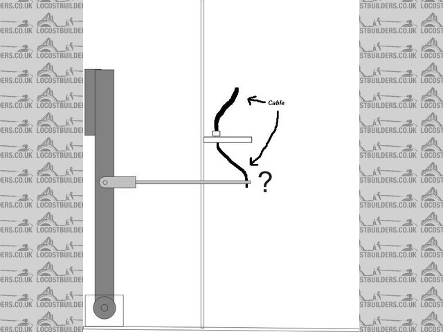

I have my pedals floor mounted and the accellerator pedal pivots at the bottom. As a result I need to pass a clevis pin & pushrod through the
bulkhead, turn 90 degrees and convert the 'push' action to a 'pull' and connect it to my throttle cable which goes back up the
tunnel to the engine bay (middy).
Can anyone suggest a quick and easy way of doing this? I was thinking about a bell crank or quadrant which bolts on the bulkhead but I am hoping there
might be something a little more 'off the shelf' available somewhere.
Any ideas guys?

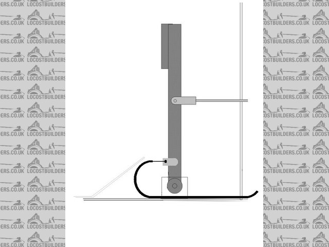

Possible to route a cable back into footwell and approach the pedal from the foot side with some sort of guard panel?

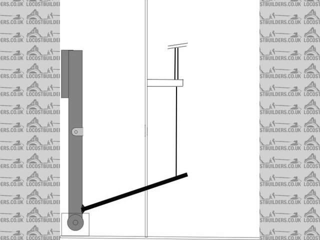

| posted on 20/5/06 at 11:40 PM |
Or ??

RazMan
| posted on 21/5/06 at 10:31 AM |
Some really creative ideas there - thanks for all the input.
As suggested, I think the most sensible way would be to re-engineer the pedal and move the pivot point up and the clevis pin can then be attached
directly to the cable. The only problem there is achieving the correct amount of cable travel - I would have to move the pivot up quite a way to
achieve that. Is there any way of 'amplifying' pedal movement?

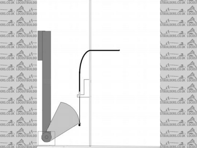

Dusty
| posted on 24/5/06 at 03:28 AM |
Possibly think of a cut down grooved quadrant like the sierra clutch one. Nice linear pull, no extra friction and no levers. Adjust radius for
ratio.
[Edited on 24/5/06 by Dusty]
