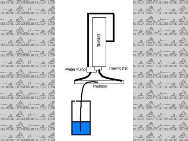

Hi Scott, I too expect your gauge is reading wrongly but you probably need an overflow bottle to sort things out. Look here (if it works!) on Dave Andrews site. Bottle
posted on 15/7/06 at 11:40 PM Reply With Quote
I have a setup using a Mk2 Escort radiator running the bleed from the top of the thermostat to the header tank neck and the pipe from the radiator neck to an expansion bottle. I didn't use a header tank before but it was a pain taking the nosecone off to top up. The pressure cap is on the radiator and a screw cap on the header.

Can't see how you are bleeding the air out of the rad when running. Looks like air will gather there and reduce cooling flow through the engine. Then heat soak on stopping blows the water out. I would suggest getting rid of the header tank and fit a simple overflow with 'suckback'. Main advantage is it gives a system which will bleed air from the rad while driving. This assumes the micra rad has a pressure cap with overflow on the top.

Sounds like you have an air lock. The top of the expansion tank needs to go to the little pipe on the termostat housing. Also, check this isn't blocked with silt.

You only need one pressure cap, which should be fitted to the highest inlet of the two you've got. You can get a cheap dummy cap that just closes the hole, rather than having a sprung valve.
I would strongly recommend the overflow tank - my engine pushes out roughly 1/2 litre of water when very hot, but pulls the same amount back on cooling. You can get away without it - many do, apparently - but it's so cheap and easy to rig up that you might as well do it. My tank cost me £1 from a scrappy, including the bit of rubber tube to connect it up!
