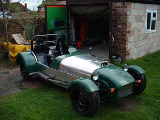

| posted on 13/6/03 at 09:14 AM |
Mine is about 60mm higher so I put a lump (scoop) in the bonnet to clear it. I wanted to finish it so I didn't go into any great complications,
just cut it out and riveted it on. Now I'm used to it I don't even notice it.
