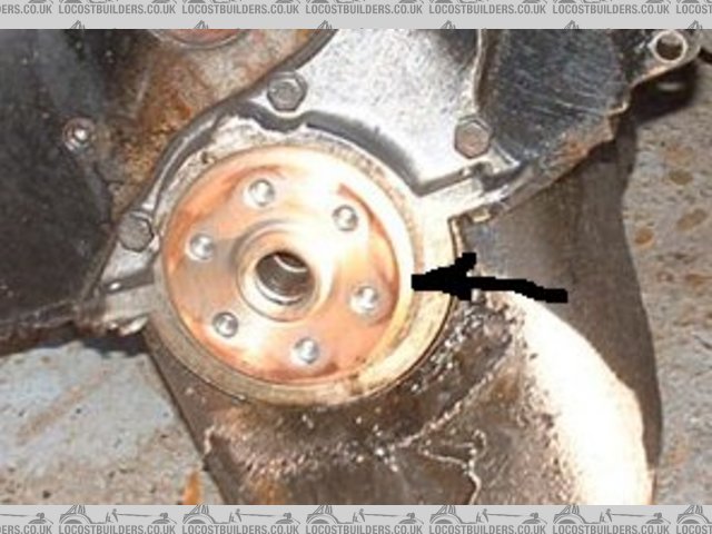

I have a X flow and it was mated to an auto box. I am converting it to manual but need to know what i need to take off in order to get the std flywheel to work.
What do i need to take off from this photo?

Does the flywheel not bolt straight on?
Also I would replace that core plug before fitting anything
Mark
posted on 7/3/07 at 09:41 AM Reply With Quote
It's hard to see from your photo, but I think you've still got the adaptor on the end of the crankshaft - that'll need to come off. It took some 'persuasion', but it's only a tight fit - no fasteners, glue, or whatever.
And don't forget a new bearing in the 'ole!

Yep second the replace core plug.
Replace/Fit new spigot bearing, I presume that its being mated to a type nine as opposed to an early three rail. The early three rail gearboxes had a slightly thicker nose on the input shaft. So if that is the case then you would need a specially made spigot bearing. (I found this out years ago fitting a Xflow onto a 3 railbox in a Mk1 cortina, had to use the mk2 cortina 3 rail gearbox.)
Fit flywheel & clutch.
Fit engine in car.
Enjoy.

Below is another pic of that part of the engine.
Which bit is that? The bronze coloured bit is what the old flywheel bolted onto. Don't i just bolt the new std flywheel to that and insert a new spigot bearing?
Thanks for the help so far!!

The engine is a GT spec jobby from a Mk2 escort Auto (used GT engines apparently!) and the g/box is from a Mk1 1600GT so the spigot bearing 'should' be easily available. I'll give Bertons a ring in the morning for a new one...and core plug!!

posted on 7/3/07 at 03:50 PM Reply With Quote
This picture shows what I think is the end of your crankshaft. Best move is to offer up your manual-type flywheel to the end of the crank - if the end is about 1/2" too wide for the flywheel recess - you've got an adaptor to remove - the bronze-coloured bit.
[Edited on 7/3/07 by David Jenkins] Rescued attachment xflow2.jpg

donut
posted on 7/3/07 at 03:54 PM Reply With Quote
Cheers fella, I'll give it a go!

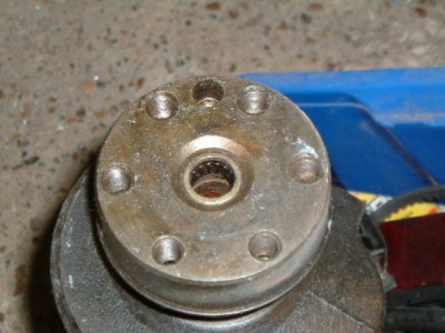

This may help - a photo of the end of a spare crankshaft. so you know what you're looking for...
The crankcase seal rides on the round bit at the end.

Ok i thought i would have a fiddle with the brass thingy and it almost (with a little help with a screw driver) came off in my hands. The flywheel fits a treat and all i need is thespigot bearing. Wahoo!
