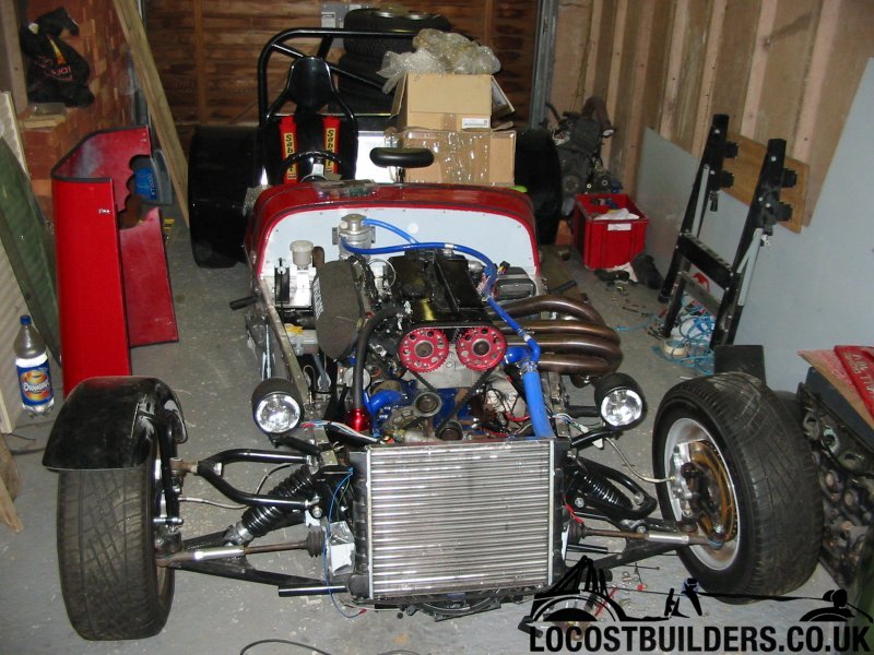

Hello,
I have done the modification to the oil catch tray in the rocker cover and blocked the smaller of the two outlet pipes. What I would like to know is
if I can get away with a little filter as shown in the attached photo or should I really go for the catch tank?
NS Dev
| posted on 15/4/07 at 05:43 PM |
catch tank mate, on some hard corners it will chuck some oil, best to have the tank there ready for it. A beer can etc will do the trick, you just
need something to take 250ml or so

Catch tank - it is only fair to motorbikes behind...
