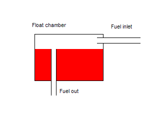

Its his way of making them work for offroad racing
I think you remove the floats and replace them with a system that uses a second fuel pump to scavenge the excess
I'll see if I can get teh details later if you want
MikeRJ
| posted on 17/4/07 at 03:49 PM |
Re: Vizard mod,
Float is removed, and a scavenge pipe is mounted vertically in the float chamber, coming out of the bottom via a gland. Height of pipe within float
chamber determines fuel level. Main fuel pump pumps all the time, a second high flow fuel pump on the scavenge side keeps level from going over the
top of the pipe.
The float chamber is foamed to keep the level as stable as possible and reduce fuel foaming.
