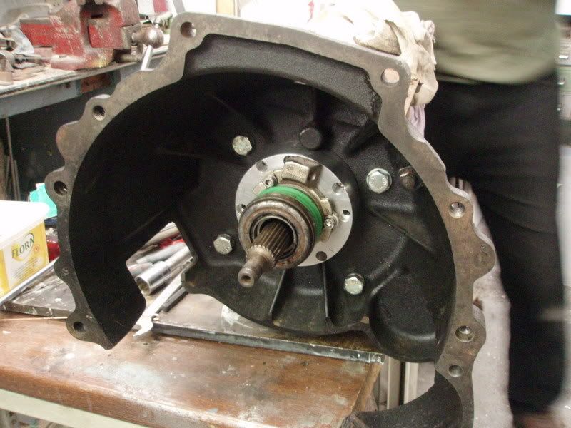

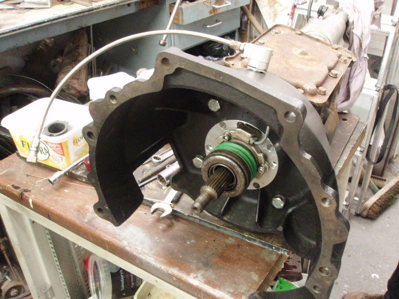

Vectra Concentric Slave Cylinder
Heres our take on a concentric clutch, made from a VX vectra slave cylinder and bleed assembly we had laying about. Needs a new bearing and the piece of billet was only just big enough as the pictures show!
Hope this gives others some ideas.
