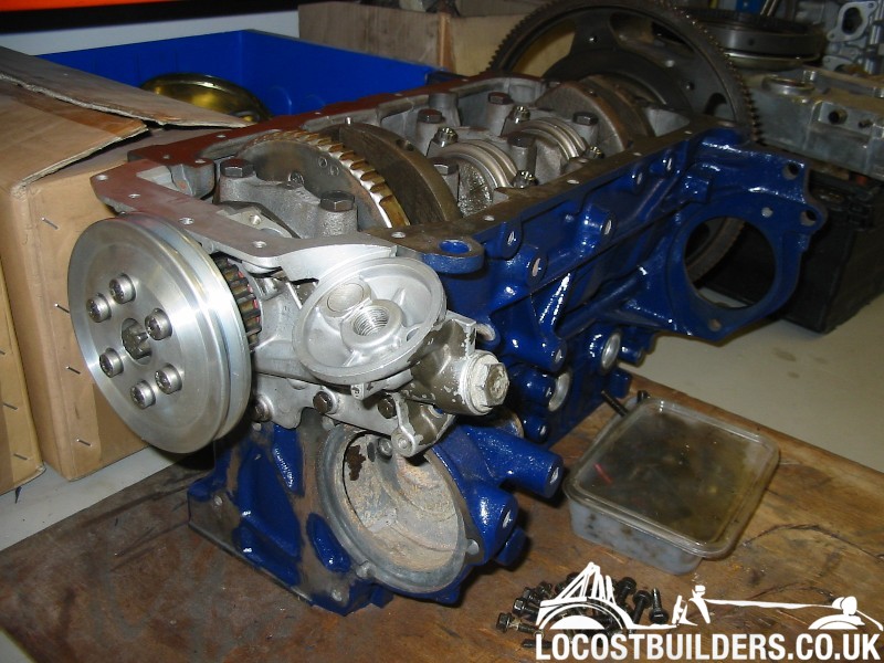

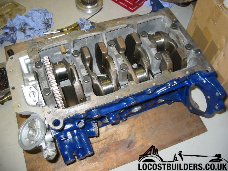

Def the PRV according to the haynes and all other references I've seen, was the cover bolt on the inlet side of the pump housing, perpendicular
to the block and just above the filter.
Ned.
here's a pic of the pump when building the engine up, there is a blanking plug on one of the holes where the oil filter goes on but I worked out
the route and was pretty sure it was because it was being run with a take off palte which I was also using.
It's the bolt as pictured bottom left where the PRV is (sanity check!)

the_fbi
| posted on 4/6/07 at 01:51 PM |
You're worrying me with your description of the location.
Its on the exhaust side of block, bottom left just above the sump line, pointing slightly downwards.
25mm spanner reqd.
I've a pic showing it somewhere, I'll find it.
ned
| posted on 4/6/07 at 01:54 PM |
Sounds like I don't understand the haynes and am looking in completely the wrong place. Sounds like I've just removed one of the spare
tappings then.
Just trying to find a pic of the other side of the pump.
[Edited on 4/6/07 by ned]
