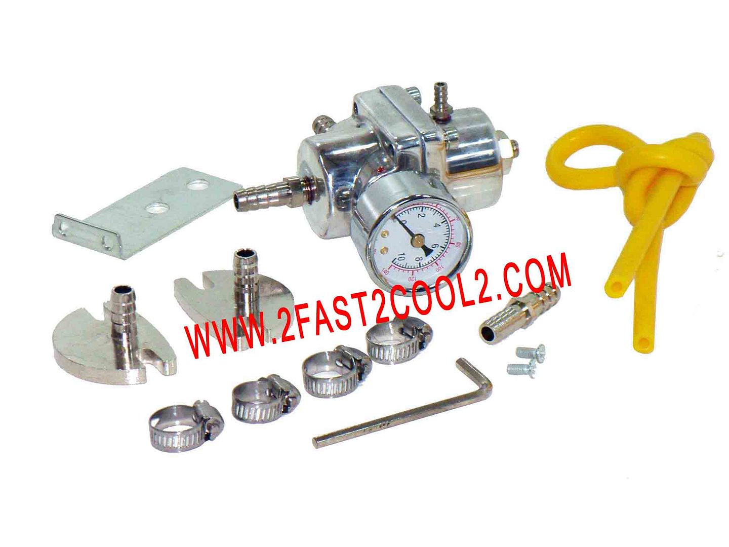

i have the input to the base! is that right??
Krismc
posted on 3/6/07 at 07:01 PM Reply With Quote
...very similar to this....
you can see mine mounted below

cool cheers, i also need to know what the other little pipe off the side is!!
Krismc
posted on 4/6/07 at 08:05 PM Reply With Quote
cool thanks, thats what i thought it was!!

It sounds to me like you have it plumbed correctly, or you would see no pressure. The small vacuum pipe is needed as not only does it increase pressure on boost, it also reduces pressure at idle so gives a wider resolution to your injectors.
The fuel pressure will depend on what injectors you are using and can be varied to increase the flow capacity of your injectors.
120psi is only good for testing your connections as I would be surprised if your injectors would work properly at that pressure.
With GSXR750 (and these flow more than 600 ones) injectors I am running 50psi and am reaching a maximum duty cycle of 72% so I will probably reduce back to 40-45psi.
At least you know that you have no leaks
