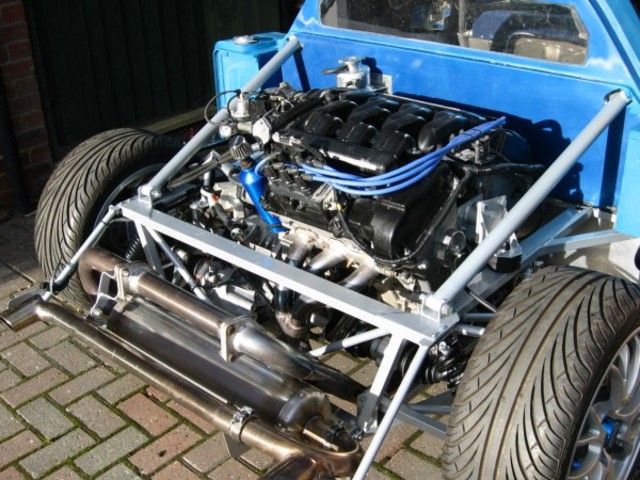

| posted on 4/6/07 at 10:20 PM |
The front bank dives under the sump and emerges next to the rear bank on the right. It then goes through a dummy cat and swoops back through the
8"silencer. I have ditched the twin outlets now and made a twin bore central tailpipe.

RazMan
| posted on 4/6/07 at 10:23 PM |
Here's a slightly better angle. As my V5 states that my engine is a non-cat jobbie I could probably ditch the cat pipe which would save some
room.
I don't really want to remake the headers - they were probably the lion's share of the exhaust cost and any fancy pipework would be very
difficult to route and be horrendously expensive.
[Edited on 4-6-07 by RazMan]
Raz

So a tubular version of the ford set up, if I read that right? I'm not sure how affective a link pipe would be, as I have no idea if it needs to
be in the same place in each header/exhaust. If it doesn't matter, then one just to the rear of the block/where the pipes come up should be
fine.
Sun Tzu, The Art of War
RazMan
| posted on 4/6/07 at 10:31 PM |
fine.
But wouldn't the existing 2:1 collector do the same job as a balance pipe then? Or is the gas flow radically different with a 90 degree exit?
p.s. Yep, it's a stainless tubular header setup (which cost an arm, two legs and a kidney!)
