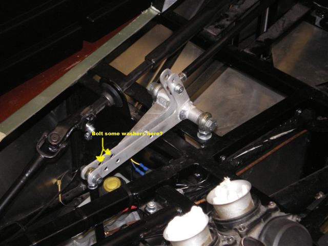

Seen as my car has been labeled "buily by committee", I may as well carry on the trend:
One of the bits I'm currently least happy with is the look of my paddle shift rocker.
Before anyone asks, it has to be that big due to the length of lower arm I am using (the one that comes from the gearbox splines) to clear the prop
etc.
Looking for a "good looking" rocker - shouldn't be hard with all the tallent on here.
Pat....JPG)

Other side:.JPG)

I actually think that looks very smart!
Howlor
| posted on 11/6/07 at 09:05 PM |
I agree. Why not just break the corners, vapour blast or grit blast to get a nice even surface finish. Other than that why not have it anodised.
Confused but excited.
| posted on 11/6/07 at 09:07 PM |
So do I.
Just get the Dremel on the welds and polish it.
Sod it! Must learn to type faster.
[Edited on 11/6/07 by Confused but excited.]
| posted on 11/6/07 at 09:36 PM |
looks like the commitee says yes Pat

Can I cut a triangle hole in the thich ali bracing triangle?
Avoneer
| posted on 11/6/07 at 09:41 PM |
Actually, that'll look worse.
Pat...
| posted on 11/6/07 at 10:09 PM |
have you changed gear in anger yet pat? Loosk a bit spindly down the long leg, wouldnt be good for it to buckle! A triangle shape would've been
better than an L. Looks well made though!

The up and down is actually limited by the ST paddles which firmly stop at each extreme so the rocker can only go up or down and never hit
anything.
The inner long leg does flex a bit if you push it, but not in operation.
Sketches of different designs welcome!

| posted on 12/6/07 at 07:44 AM |
You could give it more support by using a piece of threaded bar with rose joints at each end and triangulate byattaching it to the redundant holes on
each arm - should add strength but not much weight.

| posted on 12/6/07 at 10:27 AM |
bolt some washers or a spacer to strengthen the long leg?

Yeah, was gonna brace the empt holes.
Nice one StevieB - I like the idea of a "tie rod" between the top hole on the short arm and the empty hole on the long arm.

| posted on 12/6/07 at 11:45 AM |
Pat,
If you want technical. Why not take Steve's idea of the brace but make it from say two sheets of carbon fibre. Nicely shaped and bolt through
all of the spare holes making up a triangle. this would add strength and look good.
Or just weld a top onto the long arm section. Before you weld it on you could have some text engraved or laser cut. This would box it in and add loads
of strength.
[Edited on 12/6/07 by Howlor]
| posted on 12/6/07 at 11:48 AM |
Does the ratio work?
It looks like it should be the other way round for the leverage to change gear. The brace from top to front sounds like a good solution for flex.

It looks the wrong ratio to me too but might just be beacuse everything has been elongated to get the lever prop clearance and therefore the ratio
itself might be OK.
From what I remember of the ST blade linkage I used (on that very same engine) it was nearer 1:1 ratio on the pivot arm though, with maybe 10mm either
way movement at the gear lever, and similar (on a small actuator arm) at the gearbox end.

| posted on 12/6/07 at 07:08 PM |
Cheers chris, but I'm done with fabricating things!
The ratio is spot on.
The ST paddles have very little movement - 10mm ish.
When coupled to a bleeding long arm from the gearbox, it was the only way to do it.
Not the pretiest, but it works.
