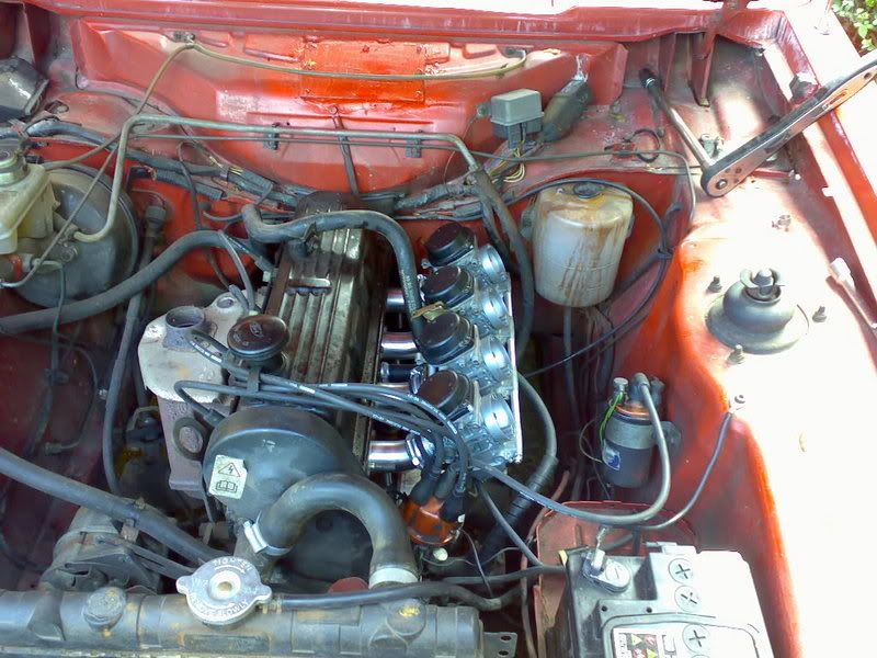

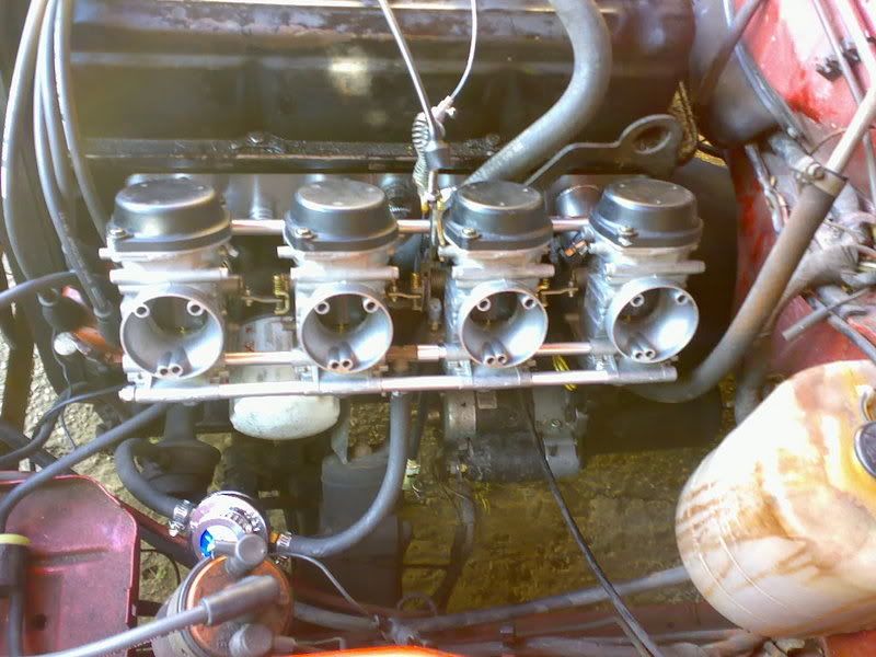

hay all, im having problems with some bike carbs i fitted yesterday, after fitting them etc got them running but with out a throttle cable, so tonitie i fitted a throttle cable to do this i had to modify the standard capri one (hehe bike carbs are fitted to a pinto in my capri), any way with this done the throttle opens to soon, pretty much the moment i touch the throttle its fully open what options do i have? also im in telford, is there any one that can make cutsom throttle cables, as i have pretty much bodged this one, thanks for any help you can offer
ps heres pics of my set up
cheers the snake
flak monkey
posted on 21/6/07 at 08:14 PM Reply With Quote
Sounds like the pedal ratio on the throttle is too high, re-drill the cable attachment point to give you longer pedal travel. I.e. move the attachment point closer to the pivot point.

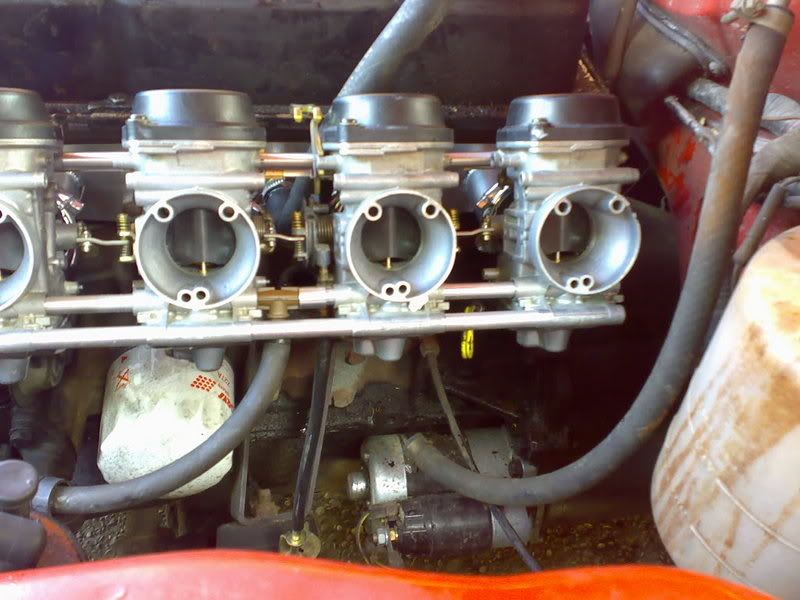

ok cool, i have done a complete bodge job on it today heres a pic, drove it with this set up today, is ok, however lacking the advance due to vacum not connected up, things can only get better!

I put a return spring looped over the cable attachemnt point on the pedal top and bolted to the bulkhead on my car, only a light spring just enough to take up the slack without opening the butterflys.
The carbs already have an extra spring to keep them closed.
