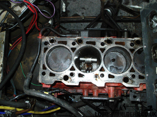

Could this be the cause of my misfire??
I reckon I might have found out why I got a misfire on the way to Le Mans.
I thought the tappets were a bit noisy!!
I guess it didn't like running over 7K for a fair time along the payage.
I have seen a few broken pistons in my time but never come across one that was completely gone. The bad news is the head has taken some abuse as well
and may be scrap. The good news is the cams are OK.
I just need to work out what caused it now. I guess either the big end bolts let go (but I am not sure as the rod is still attached to the crank
journal) or the rod stretched to the point of the piston hitting the head or the piston just broke up from the abuse. I reckon I will go for stronger
ARP bolts in the new engine.
Summer's here!!!!

Just a guess but that would probably cause a missfire  Have had a piston snap in 2 before but dont think i've seen 1 that bad Enjoy the
rebuild

Rebuild ?........................Its scrap
Still £250 will sort that...cheaper than a bike engine

I is a bit past a rebuild as the bore is scored about 2mm deep.
But at least it stayed together which saved me loads of grief. French law doesn't allow my breakdown service to work from French motorways so I
needed to drive off the payage and onto an N road.
A bike engine would have been spread all over the road whereas I could still drive, albeit very slowly, through the paystation and onto an N road.
And it wouldn't be easy to replace a BEC for under £200.

Sorry but it is SCRAP. Just think about all the metal particulates from THAT piston. They will have got into the oil ways. The problem is that you
will NEVER get all the particulates out. ANY rebuild of that unit WILL result in an un-reliable unit that you would never feel happy with.
Take the rest of the bits off the engine and turn it into a garden ornament with soil in the bores and plant in it.
Spend the rest of your hard earned pennies on a reliable engine that you have seen running and do the swop. You know it makes sense. Go down the car
auctions and buy a dog bodied 2.0 mondeo that is a runner (probable cost £250). Pull out the engine and sell the rest for spares that way you will get
some money back.

7000rpm?
For your next engine build I suggest some forged steel pistons, although its a modern engine, cast pistons are not really made for anything 7000+ for
an extended period of time.
What cams do you have? I know its a popular thing to cam up an engine and get alot more power from it, but before you do so you should probably think
about the other engine internals that will get stressed from the extra rpm. Although most engines are understressed for reliability, so uprating your
cams a little bit really won't hurt.
Im amazed this is the first piston failure I have seen on here
But seriousely, get some forged pistons next time and all should be well

ERM...... A Zetec does 7000rpm as standard. OK... maybe not in fifth though
