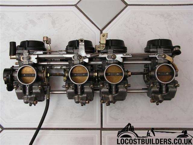

bbwales
posted on 16/7/07 at 07:45 AM Reply With Quote
Hi,
I split my carbs up, R1, the 2 outer carbs needed splitting by 40 & 45 mm. I used threaded bar to make the 2 new long securing bar and then turned down the 5 linking pipes out of stainless. for the air link pipes i used ali pipe and they work fine.
The choke i extended using round bar and the throttles i extended using flat plate.
I put ali pipe around the 2 long bolts to make it look tidier.
They do work fine.
Regards
Bob
