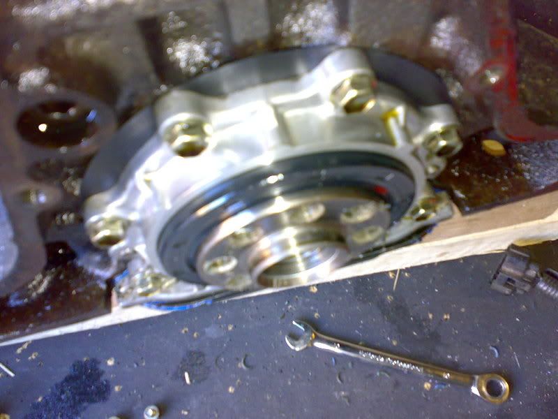

rusty
posted on 19/7/07 at 09:08 AM Reply With Quote
Found the problem
The oil seal is hanging, guess it is tesco value.
