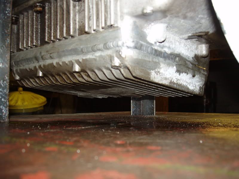

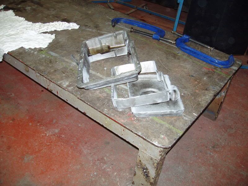

With 20-20 hindsight I would have made my sump with baffles and extended its capacity rearwards, but I didn't!
Basically I 'cut and shut' about 25mm and of course shortened the pick-up pipe accordingly.
Is this reduced capacity an issue. I'm thinking of adding an oil cooler to help with this. Should I bother bother?

Does it make sense to measure the content of the bit you cut off then leave that amount out when you fill up?
The Doc
posted on 30/7/07 at 08:44 AM Reply With Quote
Yes that's easy enough, just that I wondered whether this reduced capacity (which I would guess to be about half a litre/a pint) would cause any significant engine wear problems

I cut 40mm out of my Alfa sump and I think I'm having hot oil problems! When hot the oil pressure drops to 20psi (usually about 50-55psi) and the hydraulic cam belt tensioner rattles like a moody box of metal frogs. I have and oil cooler and an accusump to plumb in to see if that makes any difference....
Ideally, I should measure the oil temp.
Cut...
and shut....
[Edited on 31/7/07 by owelly]
