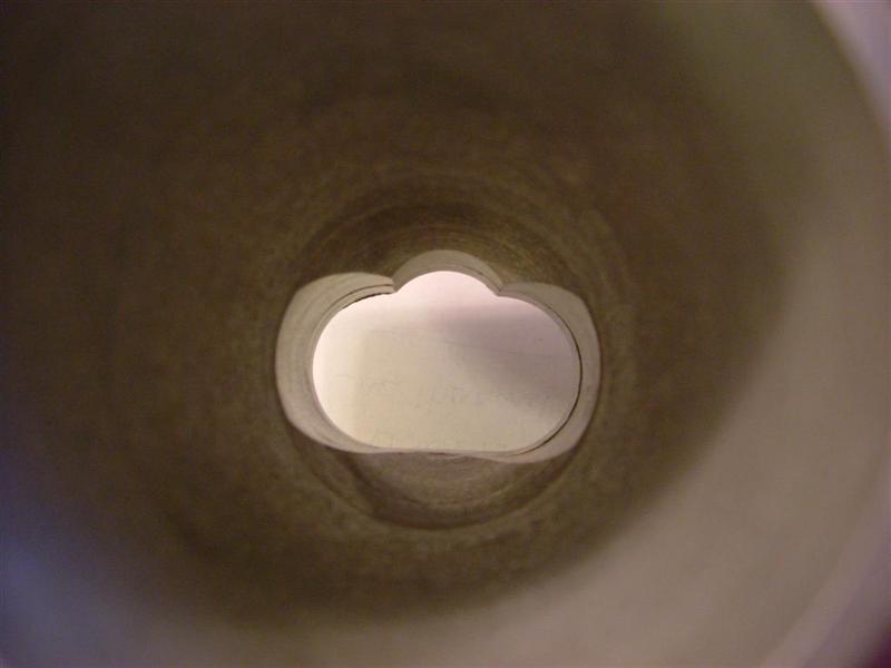

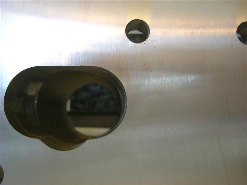

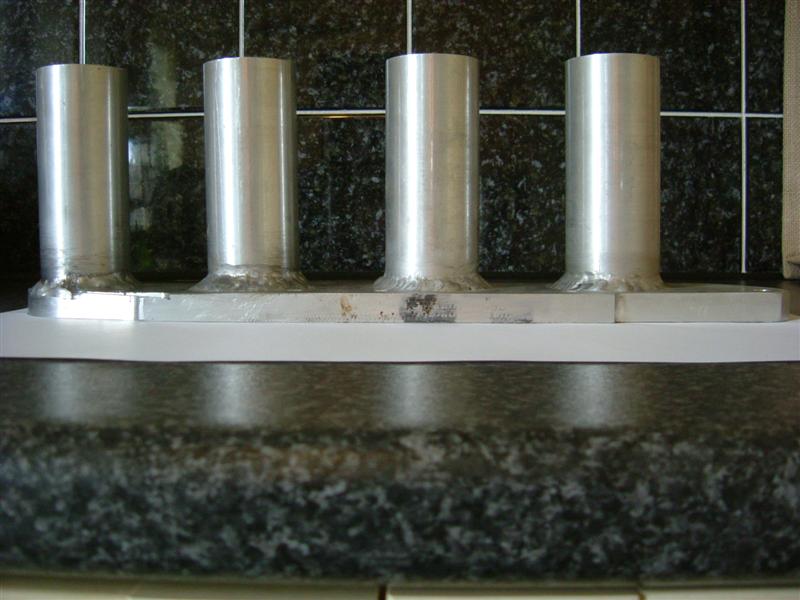

As for inlet, mine is an all alloy effort like the above link, straight runners, (GSXR TB's can be spaced to fit as they are in essence 4
separate TBs, bit of jiggery with the fuel rails, but not too tough work)
I've spent about 4 hours with the dremel carefully removing all the sharp edges and contouring them and making sure the inside of the runners
was rough / smooth enough for good flow. Probably make 0.001% difference, but it was a free mod!
They are machined properly from solid bar to go from the round inlet runner to the inlet port shape on the XE head rather than just squashing a tube
oval as others do.
Obviously that's a before picture..
Nice machining work though.

But if you look at the XE port shape:
It's not oval
2.0 XE on GSXR TBs and Megasquirt
Mave
| posted on 9/9/07 at 11:25 AM |
Hmm, that's precisely my concern about the less expensive manifolds for my Zetec. An ovalised tube doesn't match that shape, especially
the shape for the injector. The less expensive manifolds seem to ignore this. The expensive ones (Altiss) do it like this one, with machined tubes.
But than, an Altiss manifold (including spaced GSX TB's) is 650 pounds.
Well, you get what you pay for of course. But my main concern is: how much would it hinder performance if it's just a "squashed"
tube?
martyn_16v
| posted on 9/9/07 at 02:24 PM |
I've seen a couple of installs on VW 16v heads where they've gone the other way, the injector cutout in the head itself has been welded up
to make an oval port to match a weber manifold.
I don't think it'll make that much of a difference to be honest, bear in mind there's normally an injector filling up that space
anyway. The step is the right way around so that it won't impede flow terribly, you might see a small effect due to a change in flow speed as
the diameter changes. If you can match the shapes without too much trouble then you may as well, but I wouldn't lose too much sleep over it
otherwise.
GregSL75
| posted on 9/9/07 at 02:29 PM |
how much would it hinder performance if it's just a "squashed" tube?
Probably not a massive amount, but then the idea of using bike throttle bodies for me is to get the most power and responsiveness for the least cash.
My inlet wasn't anywhere near that much, (~£150-£200 IIRC) and the TBs £80 (although Ebay prices seem a fair bit higher now)

MikeRJ
| posted on 9/9/07 at 10:00 PM |
It's not oval
Agreed, it does have the injector cutout to make things awkward.
That said it wouldn't take much fabrication effort to add the bulge required to a steel tube, or injector bosses could be welded on if the
TB's being used had no facility for injectors.
Fatboy Dave
| posted on 9/9/07 at 10:37 PM |
Heh, that'll be my shop then
The injector cutout not being present is no a hinderance to a bike TB manifold. As stated, it's only there to clear the injectors spray cone on
the stock manifold as it's so close to the head flange/face.
Altiss' solution is very nice, but waaaaaaaay overkill for the sort of installation at hand - bike TBs are meant to be a cheaper alternative!
