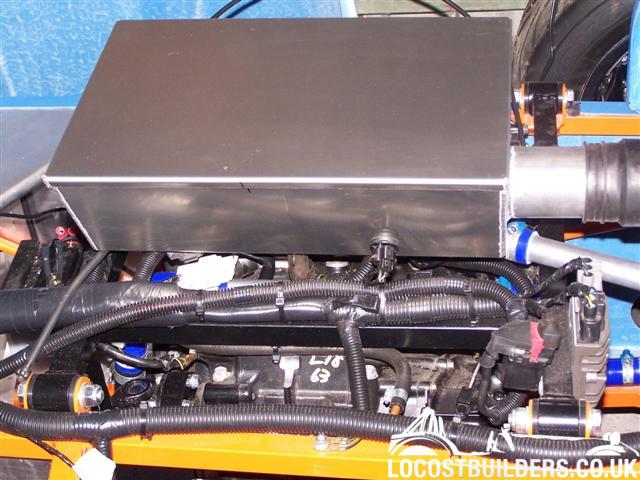

bigrich
posted on 12/10/07 at 04:59 PM Reply With Quote
been there tried that, even tried it upside down and it still didnt fit then tried cutting and modifying its size and shape to no avail so had one made in ally to fit the space i have and to use the standard intake trumpets etc then ducted it into the nose to pick up cold air and it seems to work surpriseingly well
