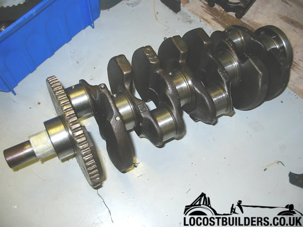

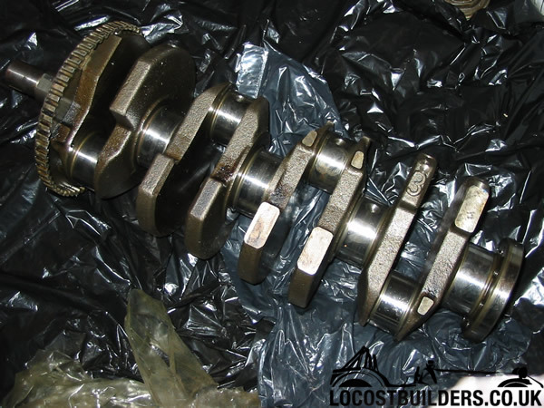

The heavier crank is chunkier across the journals, not as wasted and possibly the coutnerweights are heavier to match iirc.
ps
late crank:
http://www.locostbuilders.co.uk/upload/img_0338.jpg
early crank:
http://www.locostbuilders.co.uk/upload/img_0354b.jpg

Don't use the blued crank, chances are it's almost certainly bent as well. Don't even think about straightening it.
You'll find/detect no performance differences between the two cranks. These cranks aren't too expensive, throw the damaged one away.
