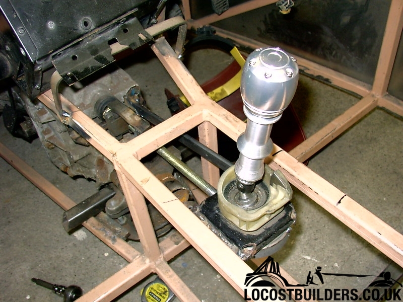

PaulBuz
posted on 4/1/08 at 08:02 PM Reply With Quote
in the car
Paul

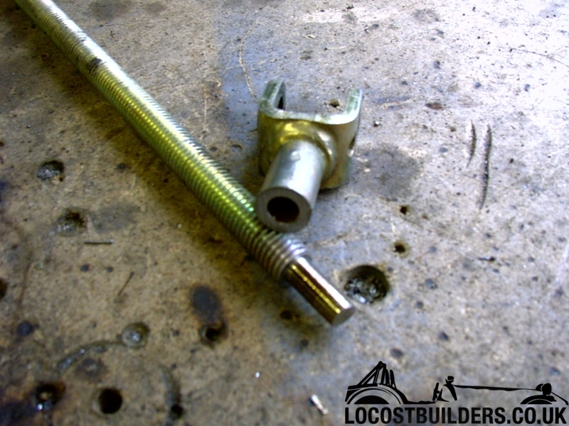

saigonij
posted on 5/1/08 at 07:29 AM Reply With Quote
in this picture,
does the rod with the twin fork end have a special name i can search for on the net?

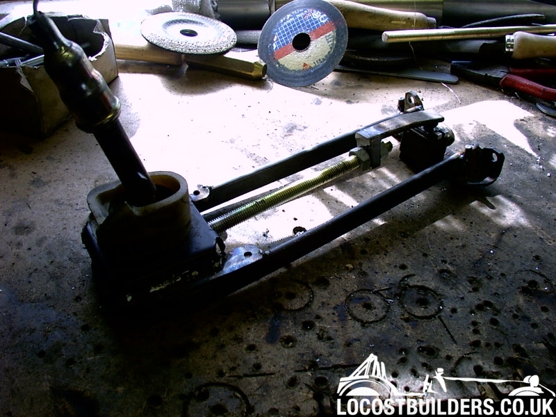

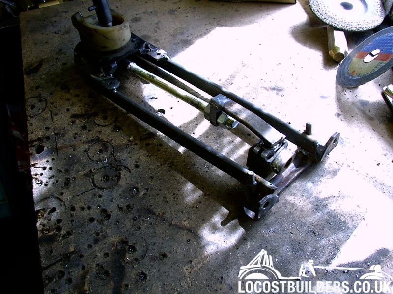

PaulBuz
posted on 5/1/08 at 03:14 PM Reply With Quote
a few more
Paul
PaulBuz
posted on 5/1/08 at 03:15 PM Reply With Quote
Paul
PaulBuz
posted on 5/1/08 at 03:16 PM Reply With Quote
sorry its a bit dark
Paul
saigonij
posted on 6/1/08 at 07:31 PM Reply With Quote

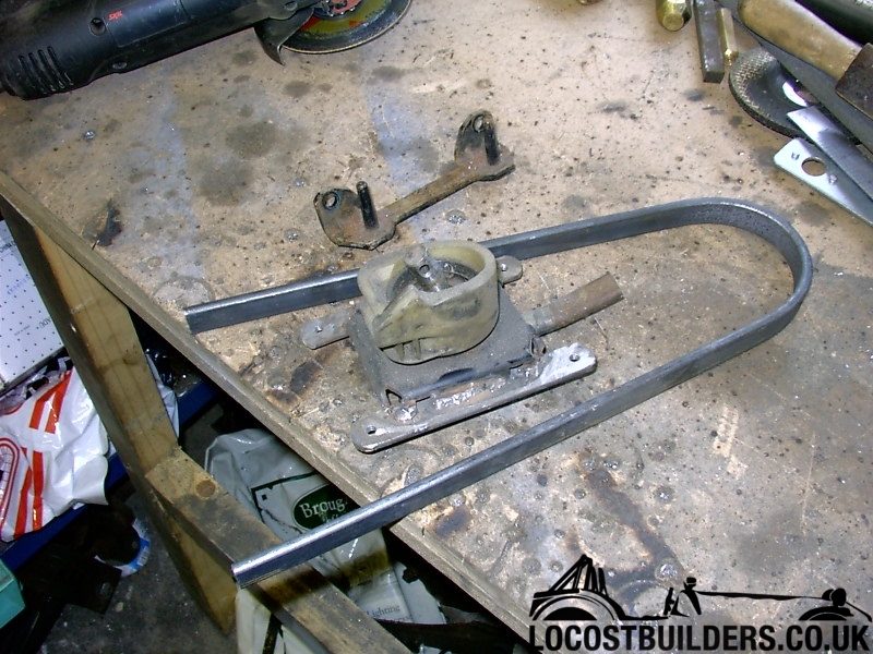

had a go at it today.
moved the gear lever 6cm further back.
i used the original cradle - be it cut down abit to remove most of the bulk.
i had two goes at getting the selector rod at the right length, but in the end im very pleased.
i have some pictures on my phone that ill upload later.
one question, i removed most of the gear lever leaving on the stubb - where can i get a new main leaver?
NS Dev
posted on 7/1/08 at 10:48 PM Reply With Quote
forky bit is called a clevis, try randall motorsport or rally design
