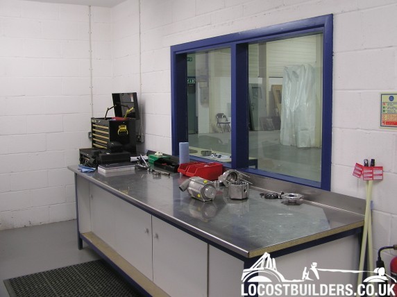

Guess what I do for a job now,
This is my workbench.
Steve.
Steve.
Sweep up using the brushes that come with instruction labels attached?
stevec
posted on 26/1/08 at 09:54 AM Reply With Quote
Steve.
Well spotted, but they are actually mops.
Steve.
Did you know there was a ghost on the other side of that window?

Is that a Rotrex with the Antonov gearbox on the workbench?
thomas4age
posted on 27/1/08 at 08:11 AM Reply With Quote
I'd say the workbench is somewhere on the TTS building/site.
looks like the antonov electrical box, justin but can't tell really good.
would love to have 2 of those on the lexus.
grtz thomas

bimbleuk
posted on 27/1/08 at 01:50 PM Reply With Quote
Well maybe but when I was at TTS last time they showed me a dyno of the two speed Rotrex and at the time the transition was too harsh for hard drivng. Was some time a go so things may have changed.
