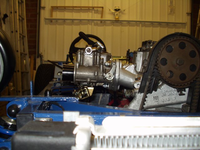

| posted on 26/10/03 at 05:57 PM |
Looks like my carbs are at an angle, but I'm not going to worry about it. I think the engine could be leant over a touch without affecting
anything.
Ned, new photos uploaded into my photo archive
