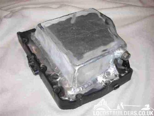

no it does not need it lots of lads just get a large modded zx12r sump done and some fit a baffel plate and all works very well there are lots of 12s out there runnig this mod i may have a modded sump for sale soon as done by mk

sump mod i give in it wont show picky

i have sent picy to hellfire so see if phill or steve can post up for us paul
[Edited on 27/1/08 by imp paul]
Hellfire
posted on 27/1/08 at 05:04 PM Reply With Quote
Here you go Paul.
imp paul
posted on 27/1/08 at 08:03 PM Reply With Quote
cheers mate nice 1
